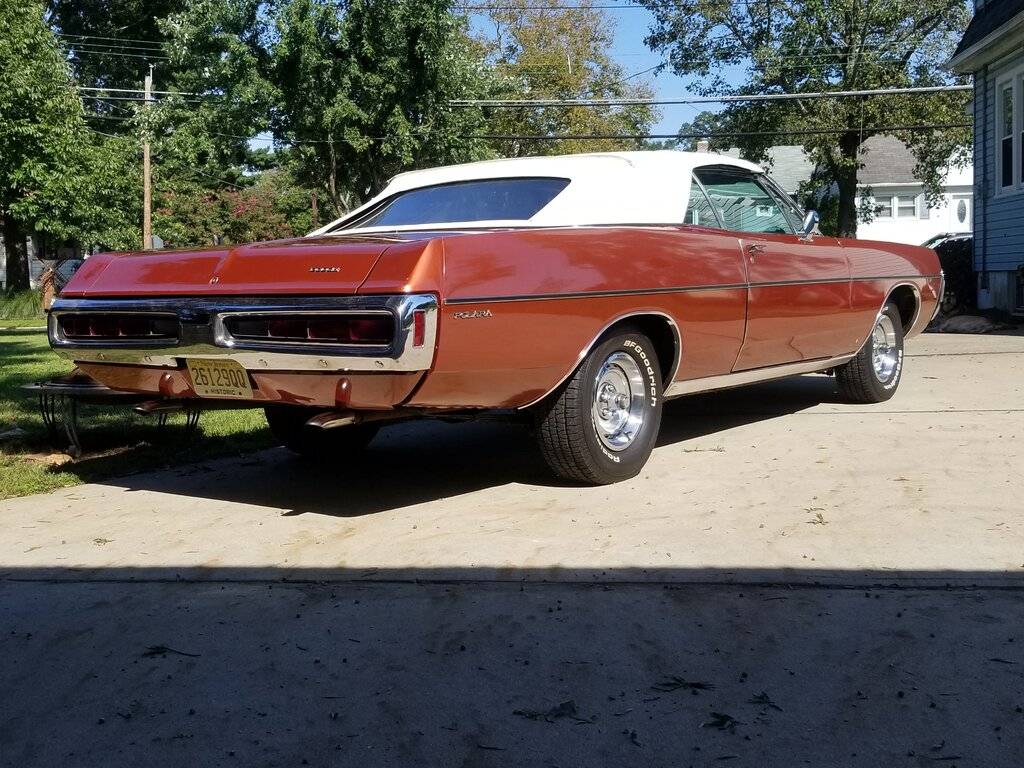

Looking for shocks for 70 Fury convertible. Think I found my answer. Any side-view pics of ride height for 70 Polara? Thanks, Ben
All of my cars have KYBs and original springs. I have a number of pics in the Fusie Pics thread. Here is one of Poppy, my red 1970 convertible Polara, from the angle you probably want.
There is a thorough discussion of ride height in the thread from when I bought Poppy. Here are photos that show the factory stance.
The ride height is determined primarily by your springs, not your shock absorbers.
Medina, my ‘71 Monaco, had air shocks when I bought her. Original springs. Her butt stuck in the air. With the KYBs, her stance is back to original.

It’d be silly of me to argue that there might be no sag at all after half a century. This said, the stance of Poppy (and, for that matter, my other cars too) looks very close to original. That is why I provided the factory photos.

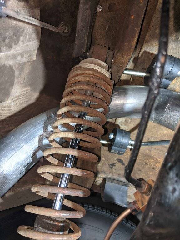

Thanks for the tip, Ayilar. I'll need to do front shocks eventually. First, I'm going to see how the back sets up without 20+ year-old rusty helper springs. I may have to take @polara71 Dave's advice and buy new leaf springs first, or have Thurston Spring re-arch/rebuild mine. (Exhaust has been adjusted since pic.)
I know we're disagreeing on shocks :poke: but don't waste your time and money on re-arching/rebuilding.
Also, don't forget that the offset rear shackles aren't obtainable new, even though there are listings for them. Most likely, the spring shop is just going to bust the old ones.
