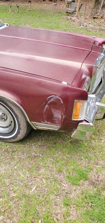

Uncle said he thinks its a fuel issue. Flooding. We found a carb from a 72 340 and slapped it on for sh!ts and giggles. Carb sat 10 years on a shelf and... ill be darned if I dont adjust the idle screw and the thing runs like a scalded dog! I set the points for safe measure and bumped the timing to 15 degrees. Left a 20 foot blackmark in the highway. I took the top off the carb and somehow both metering rods bent, and one of the floats was way off too not where I set it. Tries to readjust again and the tab broke. Was weak metal other was almost same way. So I think I'll leave the 340 carb on, seems to run better that way anyways.
The points adjustment helped too. Runs at 190-195 with the 15 degrees so there's no funny business there.
Also got a fresh dent in the front fender backing out the shop. I glanced and thought my corner was clear but then I bumped the shop door side. 2 dented fenders now. One my fault tho so ill accept it. Looking for 2 fenders if anybody has them, need the ones with cornering lamps.

Sorry about the fender. That sucks.
