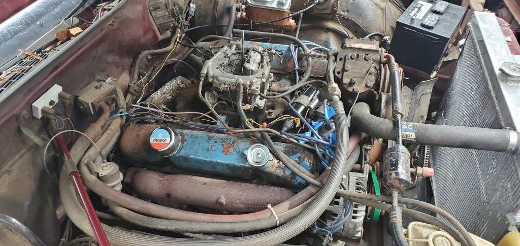

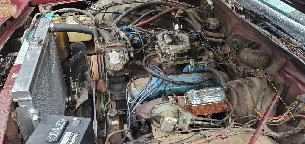

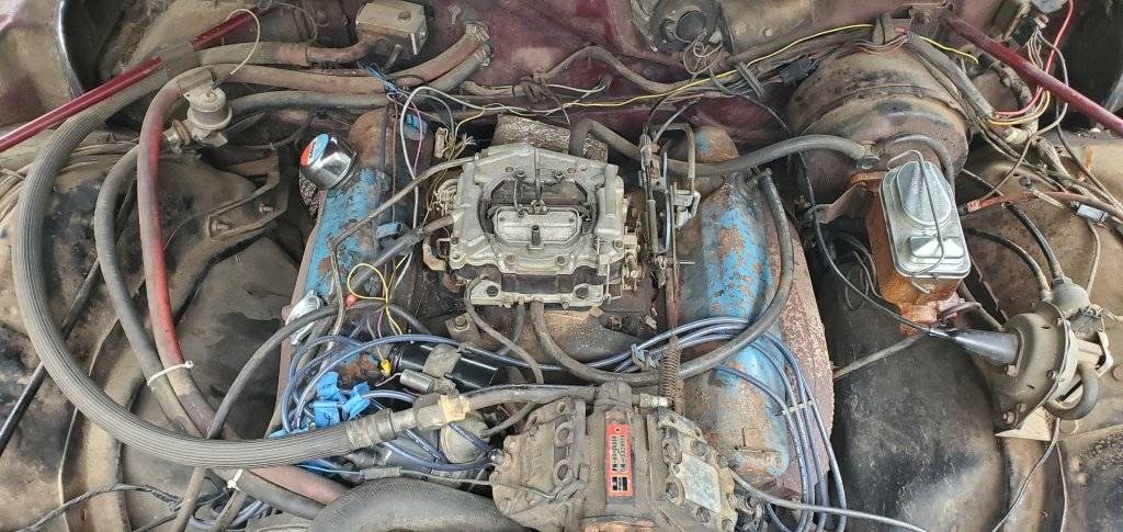

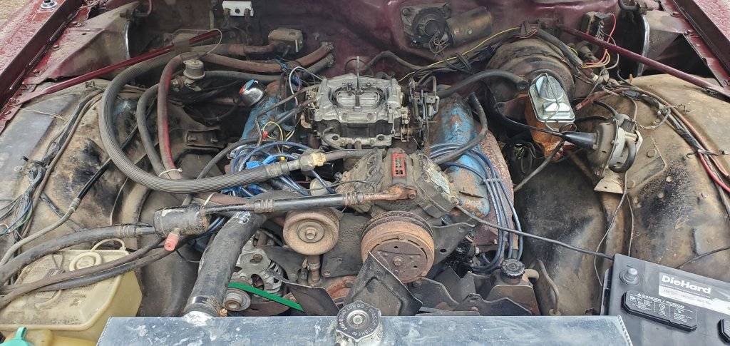

Show us clear pics of the engine [without the breather] and the spark plug wires to start. Posts like this remind me of the people who call the high tech help desk and tell us "it no work" "come fix" and have no clue what the machine serial number is let alone the model. Yes, very complicated technology but the principle still applies when seeking tech support.

Here's my V8 juice
