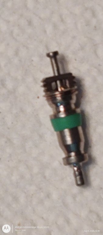

This bolts to the back of the RV2 A/C compressor on my '66 Imperial. None of my spare compressors have this exact valve. Looking for one. Anybody have one for sale???

Looks like I have one like that although maybe taller. What is wrong with yours?
This valve inside the assembly is the problem. This part cost me a dollar. I went to a local auto A/C specialty shop, described the problem, and the guy looked at the above pic, thumbed through an actual paper parts book, walked back to grab this part, and boom! Great service!
And now, to get the car over to a buddies' house where I will regain icy-cold air in the ragtop!
