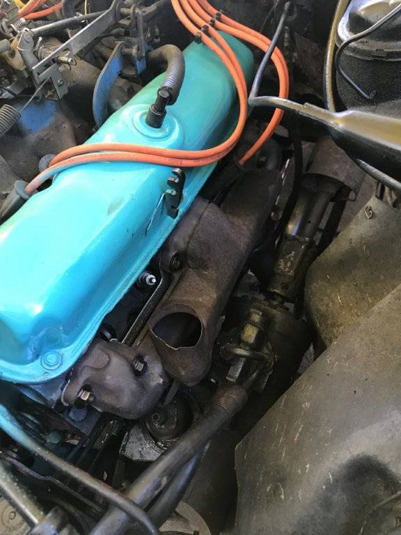

Thanks. I have a small block so it used a gasket from the factory, and they aren’t HP manifolds. It was a PITA but I just got finished. Cleaned everything up really good and was easy to bolt up with all new hardware. I did wrestle getting the up pipe back onto the manifold, because the starter , steering, and downpipe itself made it a bit difficult. Otherwise though it’s all back together. I havent started it yet... but will post a video here shortly.

Just an update for you Jon. I removed the manifolds last night. Broke a couple studs, but with patience, a torch (oxyacetylene for me), and plenty of Kroil I was able to get them out. If you look a few posts back I posted the hardware needed if you replace existing bolts. Removing the manifolds from the downpipe was a bit tough. Had to get under car, shout a little, but wasn’t more than 10-15 mins under car.
Something very important was I went to my machinist and he let me use his planer (super low grit belt sander) and I was surprised how warped the manifolds were. I took a while to get them flush enough that I was convinced the gasket would seal. So if you do this 100% spend the $20 to have them planed. Also I know it’s a bit boo boo, but I used a Dab of high temp RTV at the very back part of the head where it’s narrowest, and a little around the front and rear studs where the water jackets are. What a MONSTER difference to be rid of that nasty tick tick noise!
