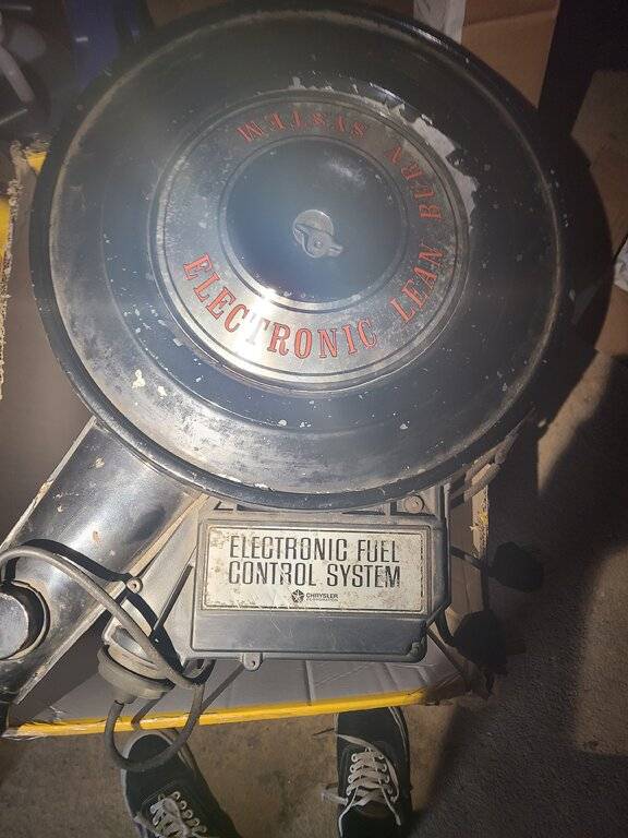

Hey guys, here is an update. I do have a sticker in the driver's door, but it is totally blank. I also have a big sticker on the rad support, which I have included a picture of below. I don't know if any of the codes on there mean anything, but I cannot find anything else for it.
Also, I noticed that my Lean Burn Box says "Electronic Fuel Control System" while most that I see say "Electronic Spark Control". Does this mean anything?

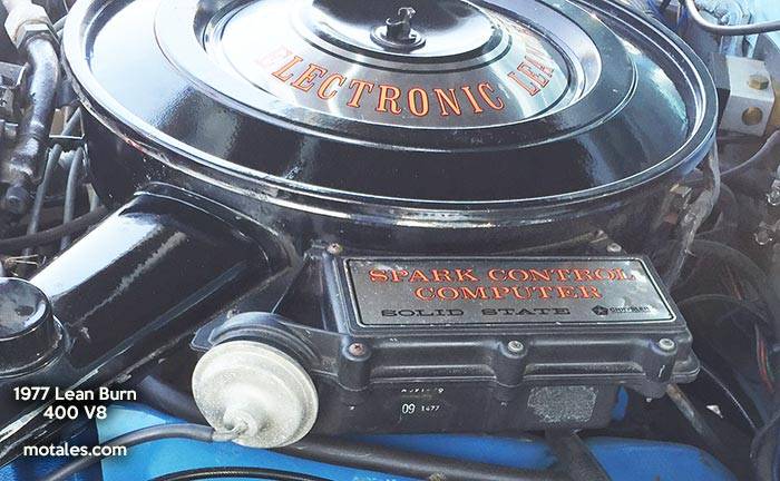

The Decal on the computer is from the 80's. So assuming that it was not a sticker swap... it looks like someone plopped an 80's 5th Ave computer on that 440.
Could explain a lot. I have no idea how a 440 would behave in response to small block programming.
I've attached a pic of what a 77 computer sticker looks like (Orange letters like pie tin. Text can vary. I've also seen "Spark Control System":

The big blocks generated more heat. They also has a good deal more vibration on the air cleaner under full throttle operation. The vibration helped to break the circuit pathways.
Dave
Wow, thank you for letting me know about the box, I did not know that. So, I guess now my goal is to find a new computer or switch to a standard electronic igntion. I wanted to keep the system cause it was original, but I guess it is not. I wonder if a period correct box would improve engine performance
