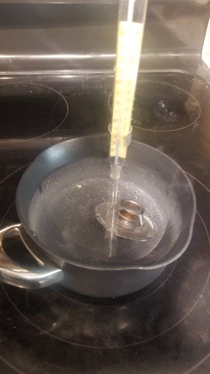

After fixing the exhaust i took it for a short drive and when i pulled in the driveway the temp light came so i check it with my temp gun 225 yikes so i sprayed it down with the hose to cool it. Im checking the thermostat its a 180 and it works the clutch fan is firm water pumps good radiator cap is good radiators been cleaned by previous owner at a shop but she still gets hot what am i missing
i had the same issue with the a/c delco thermostat that i put in earlier this year, bench testing it worked fine, put it in the car, it over heated, so i went with one of these
Robertshaw 370 Series hi flow thermostat

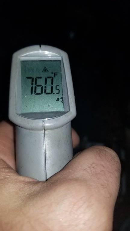

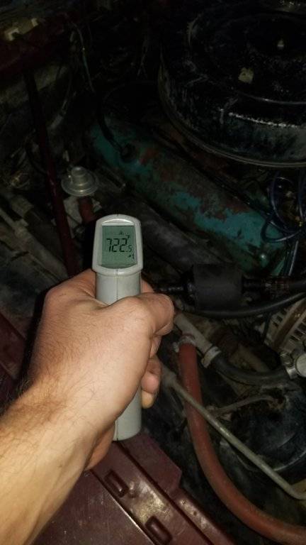

I checked the exhaust and its running up to 615 is this normal i guess ive never checked temps before

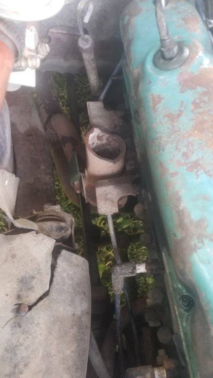

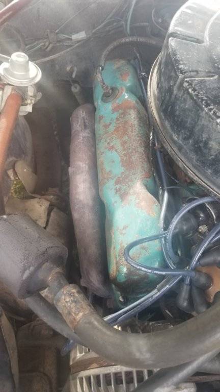

Exhaust manifold temps will vary widely depending on load and how hard the engine has been run. Check the temp on the heat riser passage in the intake manifold, if it is running the same temp as the exhaust, odds are your heat riser is stuck shut. If the manifold on the same side as the heat riser is running hotter than the one without the heat riser, the heat riser is probably stuck. Try rotating the weight for the heat rise after the engine has cooled, it should turn freely.

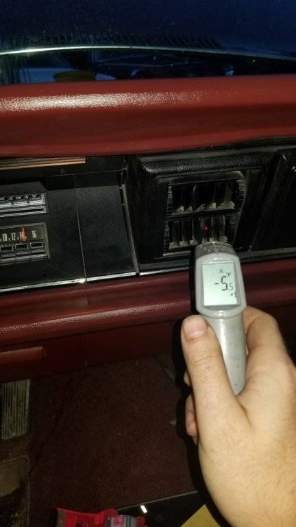

I eliminated the heat riser. I fear it might be a head gasket from previous owner using eather. On a side note the a/c blows cold i can even see my breath

Wow my small block is around 550 or less
Might be a small difference between an actual pyrometer in the exhaust vs an infrared gun

For the clutch fan to work, it has to get warmer air THROUGH the radiator. If the radiator is blocked/plugged/gunked such that no hot air gets to the clutch fan's thermostatic spring, the clutch fan perceives it's not needed AND will not engage to better cool the motor. A radiator might look "clean" when viewed through the filler neck, but use that heat gun to check the whole radiator core, inlet area, outlet area, and in between, to look for "cool spots" where the coolant isn't circulating.
On stock motors, checking the EGT at the exhaust manifold can be tricky and "iffy". On our '66 Newport 383 2bbl ('70 OEM Holley 2210 replacing the orig Stromberg WWC-3) and our '72 Newport 400 2bbl (OEM Holley 2210), with the idle speed set in gear, a/c running, at a speed where the exhaust pulses just smooth out, idle mixture to Lean Best Idle, the exhaust temp (at the end of the tail pipe) is tolerably warm on the '66, but definitely HOT on the '72. Major difference is the lower compression ratio on the '72.
When the '66 was newer and I was reading the service manuals about how the heat riser worked and why, I discovered the one on the '66 was stuck and would not free-up. It was stuck 1/2 open, not full-closed. So at my recommendation, the dealership put in a new kit. Same 1/2 open stuck situation later on. The second time it was replaced, the supplied bushing was reamed for clearance so the weight moved smoothly from the start. I could tell NO difference in how the cold start performance changed afterward. Up narth, it might be more beneficial, especially to choke performance.
I remember reading that lower CR engines had more heat rejection to the exhaust temperature, than higher compression motors did. So, use the exhaust manifold temps as a reference point, NOT as a hard, fast, universal data point. Check the port side of the exhaust manifold rather than the outside of "the log" area.
