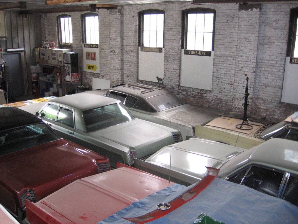

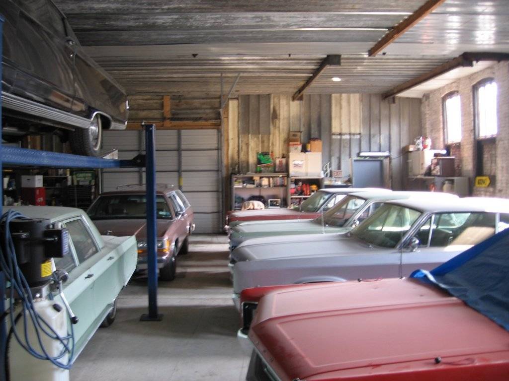

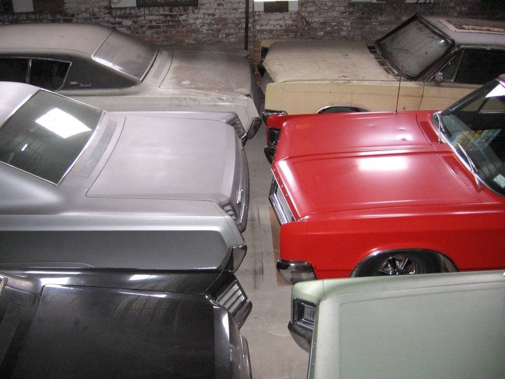

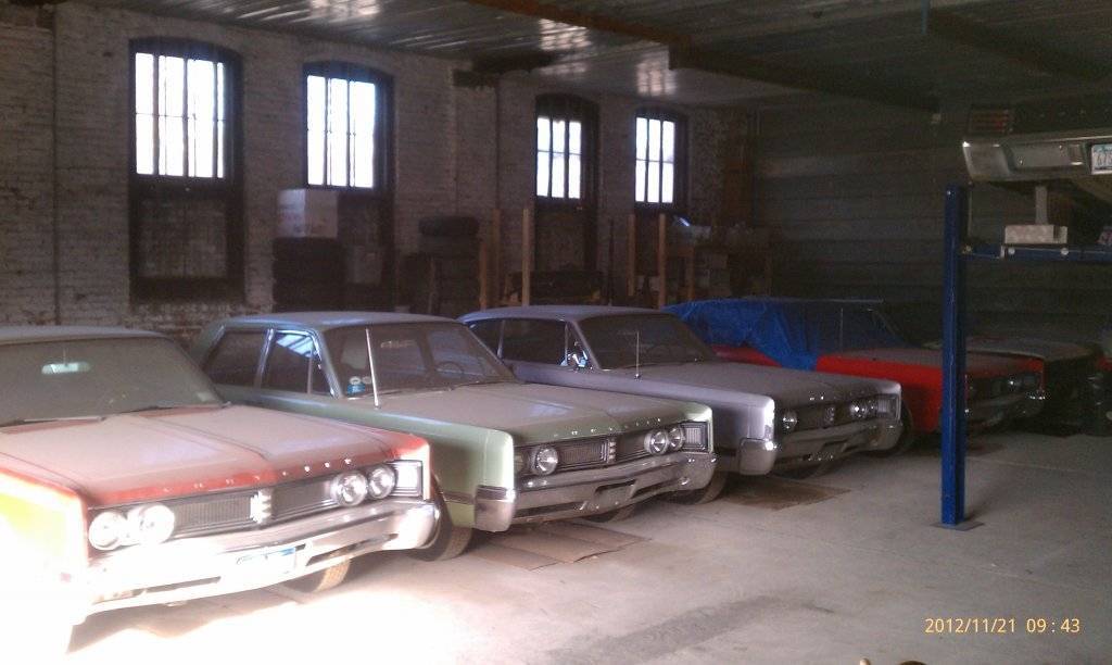

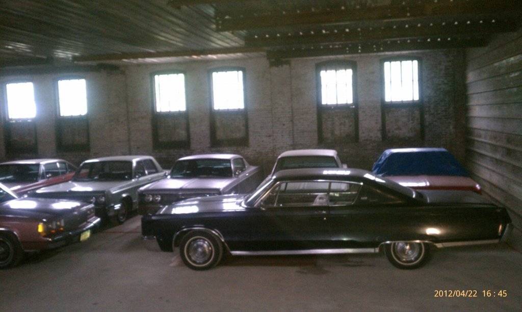

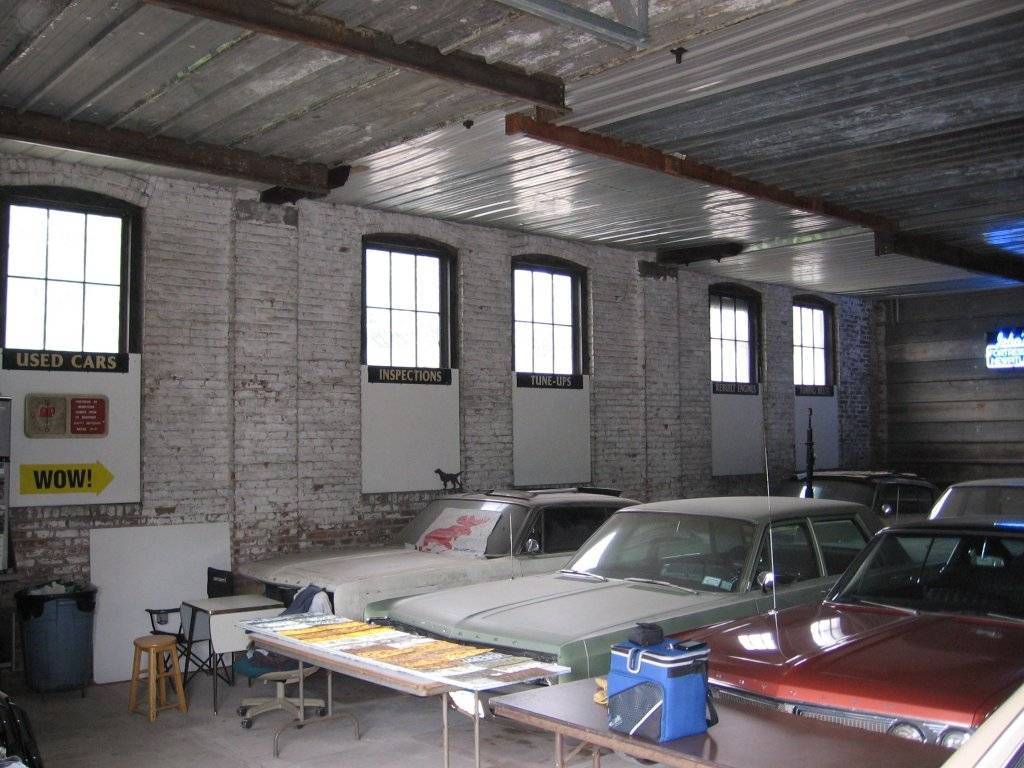

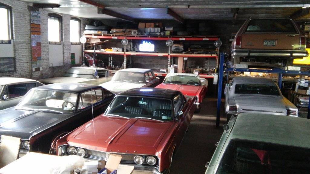

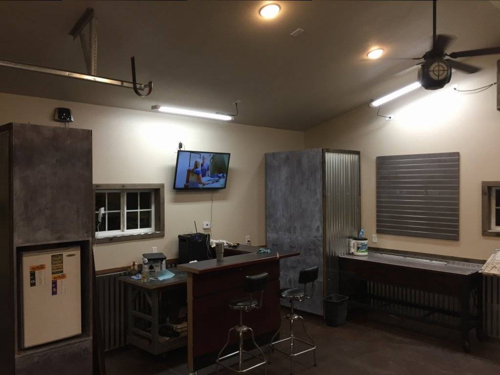

My shop is 50'x 50' with 15' ceiling.
In the 13 years that I've been collecting these cars, I've learned one thing:
No matter how big you make it, it will soon be too small.
Here's some progress pics from when I moved in almost five years ago:
Turned the cars and fit 6 where 5 used to be:
Where we are today:
Cool pics:
Hope the input gives you some ideas.
John
Where we are today:
Cool pics:
John

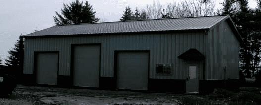

Mine's 30 x 60 with 3 bays along the long side and space for another bay with no overhead door there - deliberately done that way so I couldn't stuff so much in that there was no room to work on things and room for equipment or tools in the fourth spot. 14' ceilings so I could easily put a car or truck on the lift with the hood open and not hit the top. Works well for me, now just need more energy to work on the stuff in there........ :rolleyes: As others have said, I soon ran out of room. I'm in NW Minnesota and average heat bill is ~ 100/mo in the winter @ 63 degrees inside, (off peak electric floor heat).

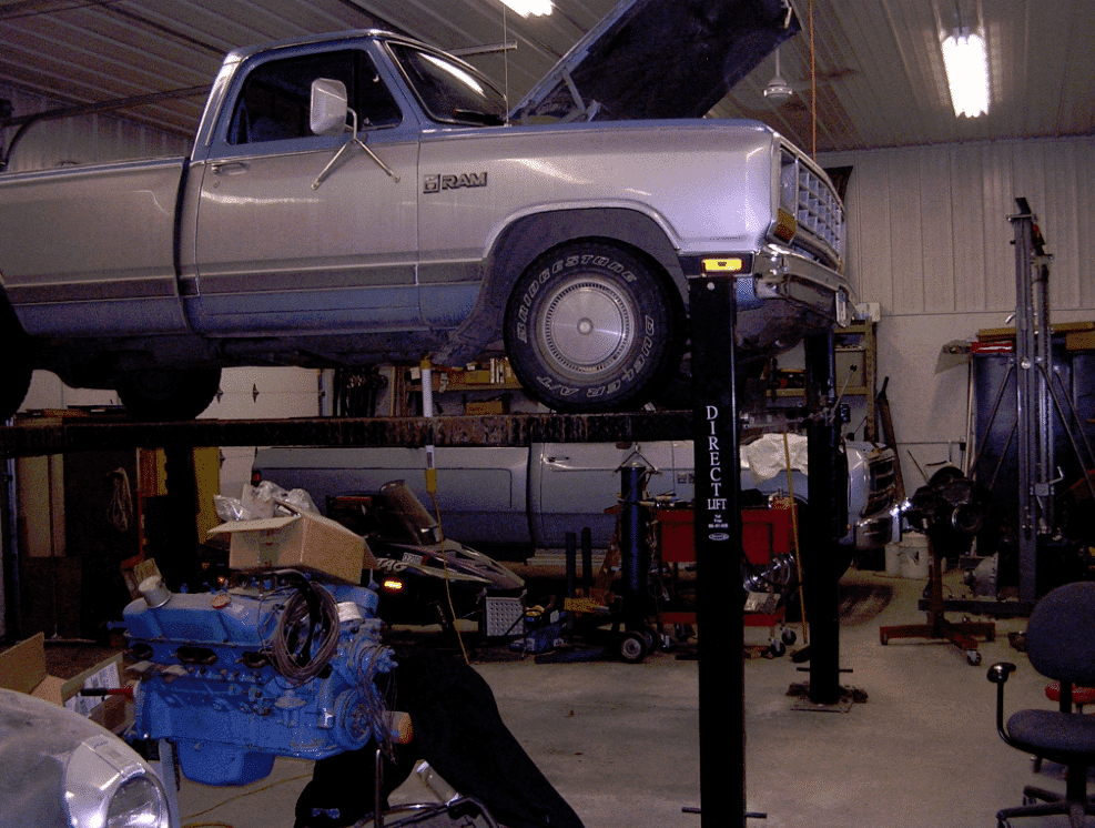

Mines 30x40 not big enough. I have t 2 post lifts one is at a angle so I can pull the Peterbilt in and use the arms to lift the engine out if the reason ever arises again, but in reality it's easier to rent, beg, borrow or steal a knuckle boom truck.

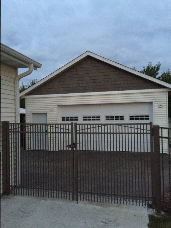

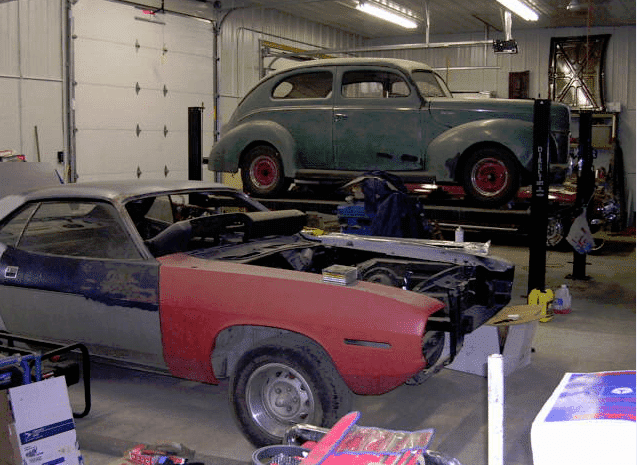

I used scissor trusses in my 24x24 garage I just built. I was limited in height by the city (15' midway between the peaks and eves). With 10' walls it gives me about 14' in the center. I am hoping to add a low height lift at some point. I should have gone 26-30' deep but was following the covenants. If I need extra room I could move some wood working stuff and use my 30' 3rd stall in my attached garage.
Here is a shot of my 24x24. Just getting things organized before my car comes back
