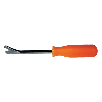

After removing door lock pin and other screws, e. g. the one holding the armrest, etc. then take good care when popping the spring clips holding the actual panel to the door sheetmetal so they don't stay in the door and rip out of the board. A tool like this one is quite useful for that:

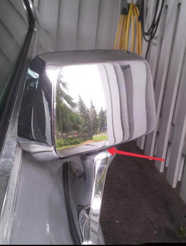

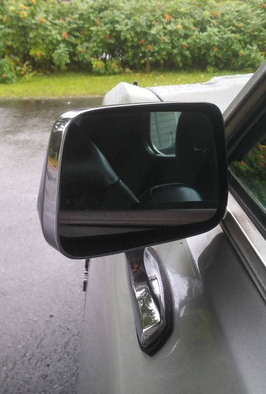

Here is couple of pictures:
Red arrow shows where I have now put the siliconglue.
I think this one is the same, but other side

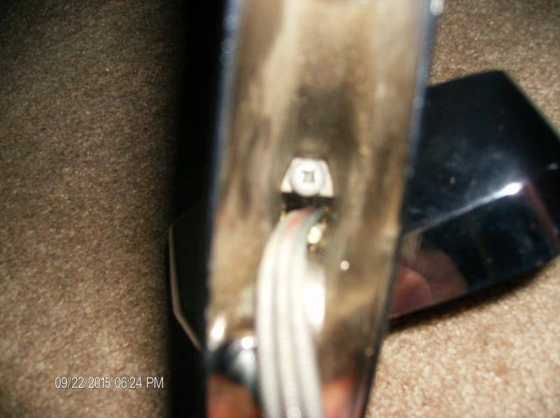

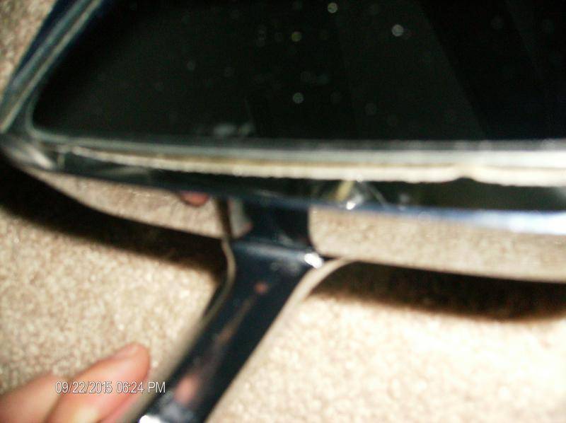

There are 2 screws that hold the pedestal and the housing together...one from the bottom and one from the top. Pic 1 is looking down the inside of the pedestal at the lower screw, Pic 2 is looking (trying to look) in the gap below the mirror where you can just make out the upper screw. Both are Phillips head.
