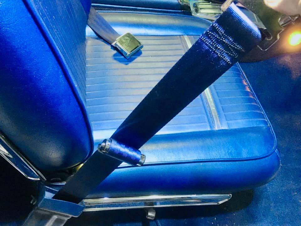

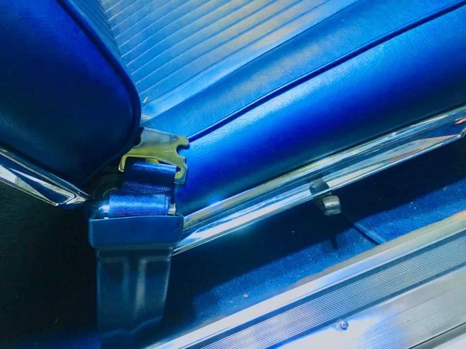

these are what i have in mine

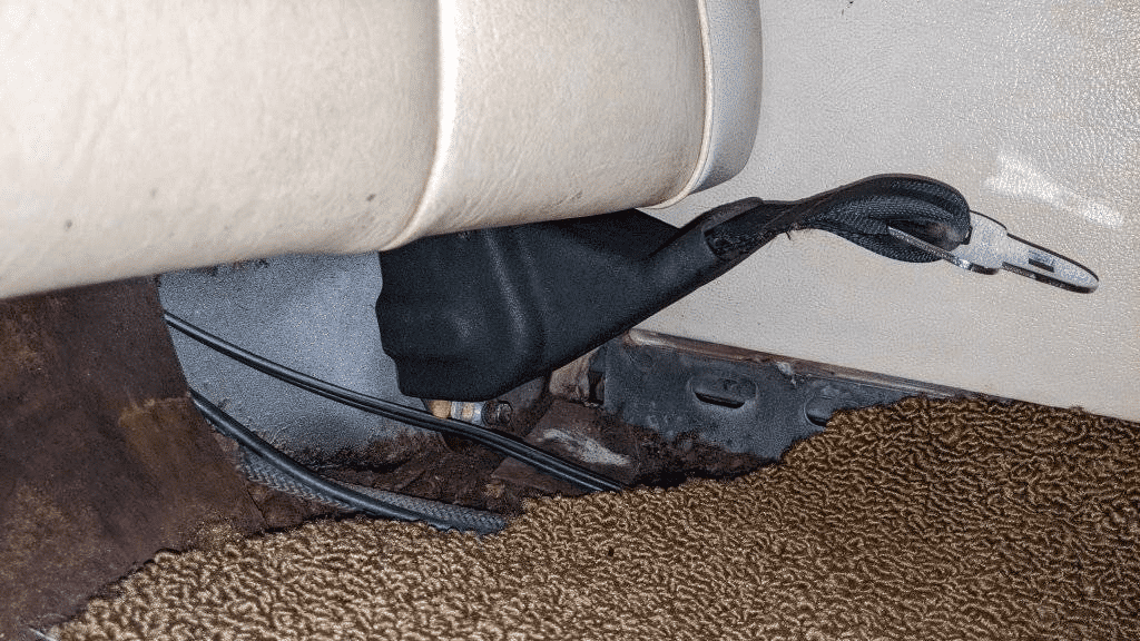

Hi Joe
I had to pull real hard to get the belt thru, but it did pull thru. Drilled out 2 pop rivets and was able to fix the tangled seat belt.
I figured the factory must've gotten the belt thru the sleeve somehow. Good luck and welcome. Ben
