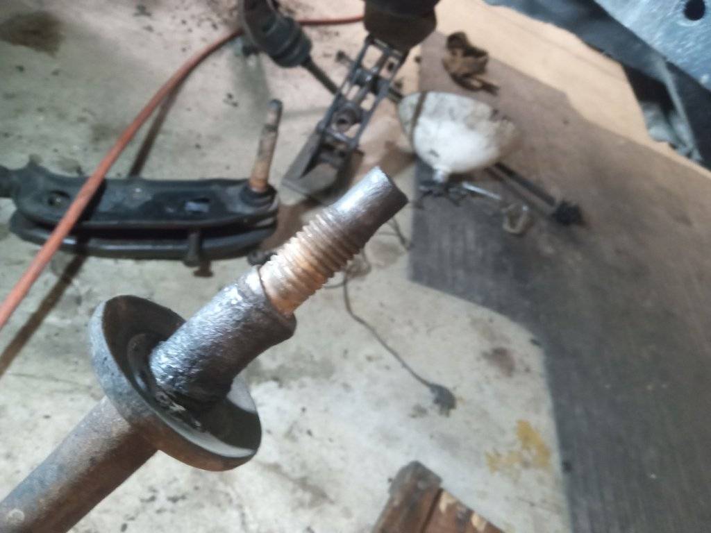

So today I tore apart the whole front suspension on my 1969 fury. As expected, everything is toast. I can move the ball joints with my pinky finger, that's how wasted they are. Every bushing is toast. I have a complete kit for rebuilding that I received from Craig at mobile parts. Therefore I'm replacing everything with good Moog equipment.

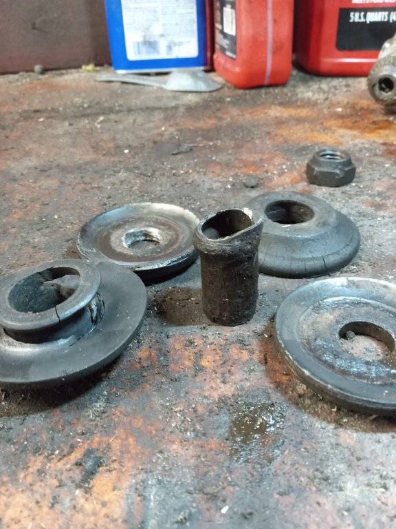

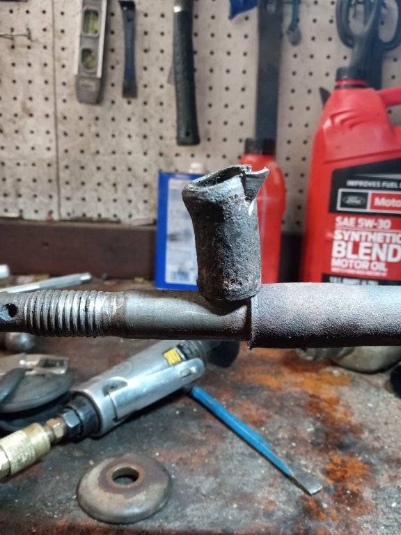

That being said, when I pulled out the strut arms, I found that the metal sleeve that goes over the strut rod between the bushings is also wasted on both sides. The Moog bushing kits do not come with that metal Sleeve. Please see the attached photos. Has anybody ever been able to source a replacement sleeve? Or do I get that sleeve off, and run the new Moog kit without those sleeves?

That sleeve you're talking about is 1.5 inches long, It's split along it's length. I measure the OD at .75 to .76 inch, 0.05 inch wall thickness, 0.65 inch ID. The shaft where the sleeve sits is 0.63 - 0.64 inch diam.
All of this is after buffing with a wire wheel. The sleeve does fit somewhat loosely now. Was stuck on there pretty good before I started to work on it.
I see some erosion on the shaft under the sleeve, not as bad as yours, but I see some nasty erosion where the swaybar is attached.

I got mine apart today. I came up with one and a half inches just like you. I ordered some tubular steel like MrMoparChp suggested. I had a split mine myself with a cutting wheel to get it off. as you can see up close there and very bad shape. I too will be using the Craig's Moog parts also.
