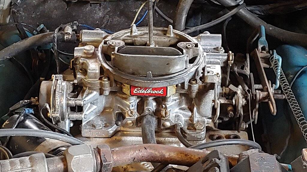

So, my 71 newport custom 383 car is a pretty good runner. I drive him to work once a week. 30 miles with a 2000' elevation gain. 7K to 9K elevation.
The original intake was removed and an aftermarket intake was installed with an edelbrock on top of the intake. I have had the edelbrock rebuilt by a local shop. I had it rebuilt as it was a very sluggish car when trying to get it going. Once going, the car rips. Runs 80 like a dream.
But I can't get the thing to not want to fall on it's face when I push the gas.
Down shift works fine and once it down shifts it gets up and goes.
Yesterday after getting to work I parked the car. About 15 minutes go by and the stucco guys ask me to move the car. I get it started but when I try to get it moving it pretty much just dies. over and over again it just dies when put into gear. When not in gear it revs just great and sounds like a great motor with plenty of response. But once it goes into gear it pretty much fizzles out and dies. Both in reverse and in drive.
After about 4 hours of work the engine is cooled down and the car starts just fine and runs just fine with the exception of the super sluggishness.
So, seems there are two problems here. A vapor locking problem after driving it 30 miles up hill.
And the other problem of the thing being a literal slug.
I know, what kind of carb? what kind of intake?
Any suggestions?
Be sure to look at your accelerator pump

Not that familiar with the 1406 but I'm sure you should be able to do a quick visual check of the accelerator pump by looking down the carb and opening the throttle manually. This should produce a strong steady stream of fuel. If not, there might m something off with the pump or linkage.
