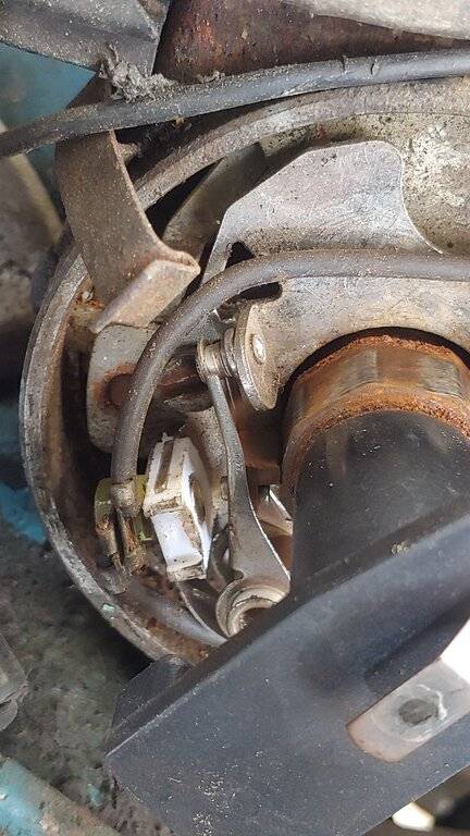

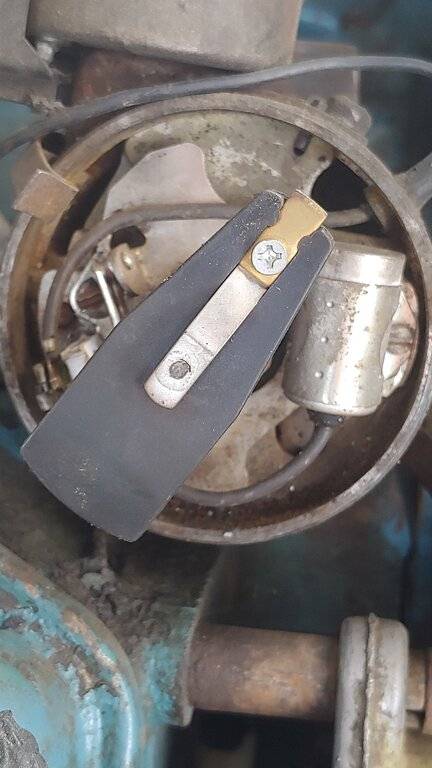

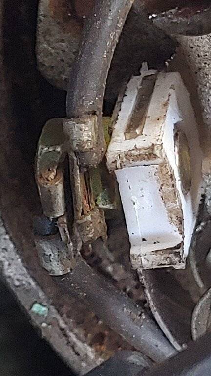

Points or Electronic ignition? I've seen it where, if it's really filthy/ gummed up inside the distributor, it can affect how the advance comes on and lead to the "stalls as soon as you put it in gear" problem.
I presume there's no vacuum leaks either...from your description of how it runs out of gear, I'd say no, but thought I'd mention it.
I will do a quick vacuum check in a little while.
i have not paid attention as to points or electronic. Will look.

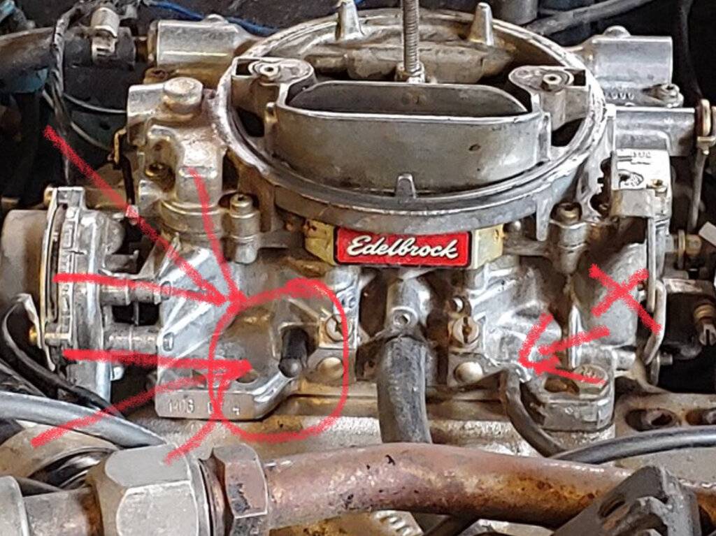

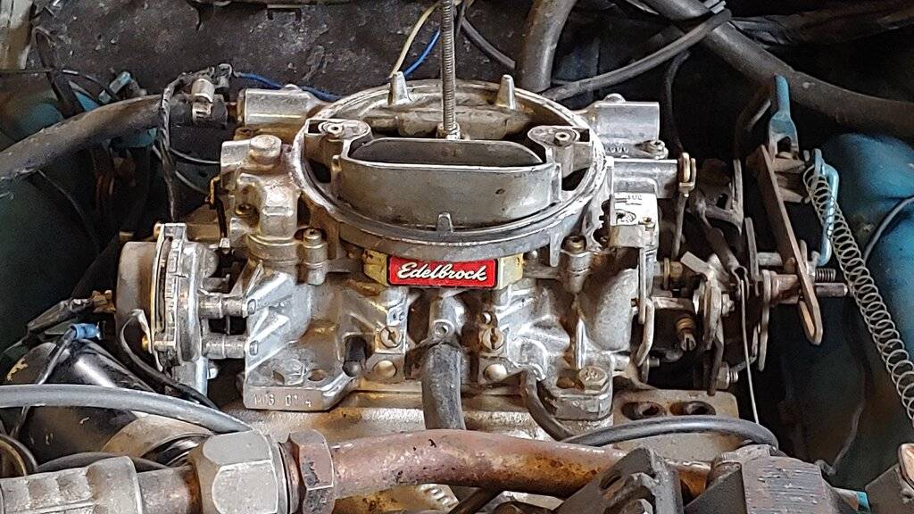

I will set timing and unhook the right hose. plug the manifold vacuum nipple.
Would the circled nipple on the left be ported vacuum? Or supposed to be?
Yes I can get ethanol gas but only at one location in our county.
And you put a 4 bbl intake/carb on an original 2 bbl carb car as stated,.
Wait wait. I did not state that I PUT the 4 barrel set up on the car.
I am slowly working on undoing the mess that was left on the car since I purchased it.
With the engine at hot base idle, one port should have manifold vacuum and the other one with a very weak vacuum (which is ported vacuum).
Ok, so would it be better to use the ported side than to use a vacuum delay valve backwards as suggested above?
I will try the ported vacuum anyway for now.
I am not opposed to finding an original set up and putting this thing back to a 2 barrel. Opinions?
Puttiong a 2bbl back on it might not help/solve anything, I suspect.
Using ported vacuum is the best thing as it ends up putting manifold vacuum (or thereabouts) into the vac advance can, but is more reliable in doing so with the throttle open. Seems like the vac advance maxs-out at a level less than manifold vacuum?
Yes swap the vacuum hose to the plugged one. And advance the timing a bunch, It should run better. That is if the vacuum advance even works.

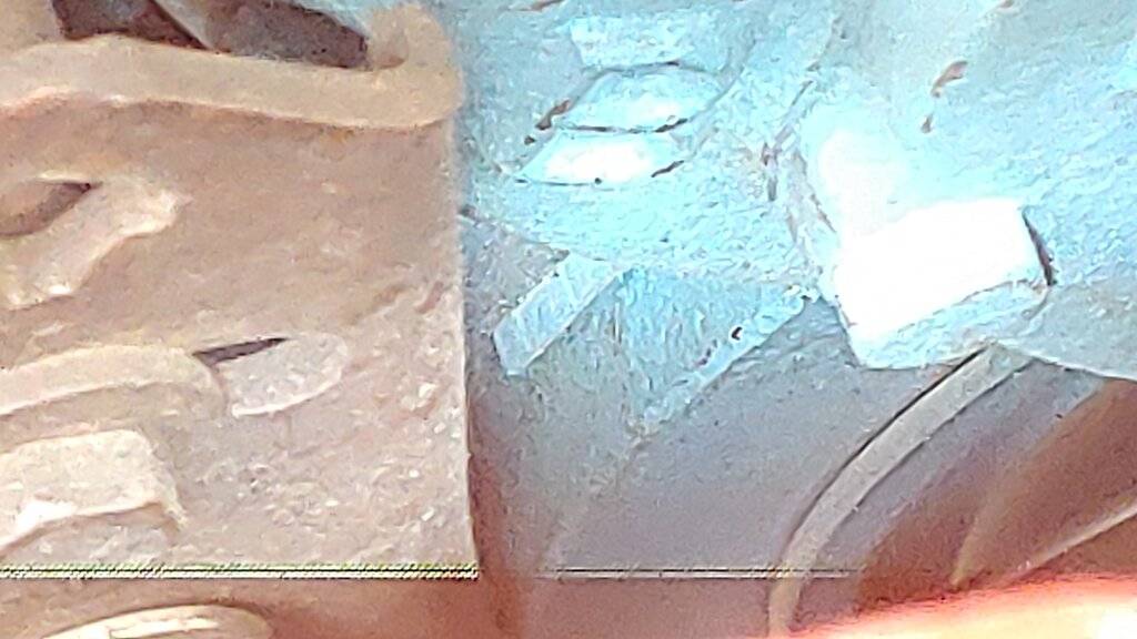

Ok, I have had this problem with this C body once. the only other time I tried to find the timing on the first C body I have owned.
With the air conditioner bracket and the idler pulley I can't see the timing tab to even see what the timing is.
I can see this much of the tab. I can't tell what the marks are with only seeing that one partial side of the tab.
Any suggestions?
