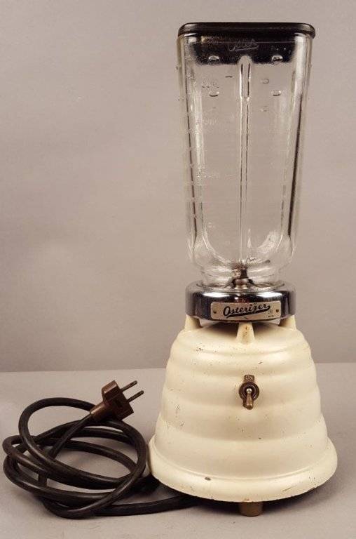

I have my Mom's old Oster Beehive 2 speed blender, the thing had sat under the counter I don't know how long? Looks like this.
When I plugged it in and ran it, it was slow as hell and screamed like crazy. Took it apart and polished the armature, commutator, brushes, inspected, oiled/greased, and put it aback together and it runs like a champ. It's about as easy as rebuilding a starter, if not easier! Geturdun! Good Luck

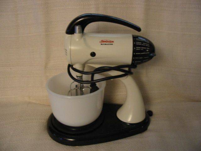

I kinda wish I had my Mom's old Mixmaster too, I don't know what I'd ever use it for but was still cool and complete. The thing had like 29 speeds on it. Same color, like this!
