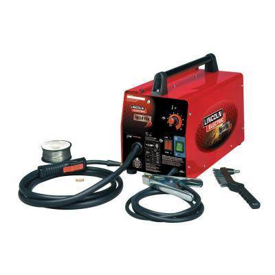

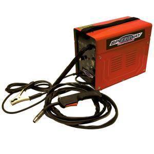

How about one of these? $169 and $269 Both got good reviews.

So, those I posted above are no good for what I need? They both use use Flux wire with no gas.
