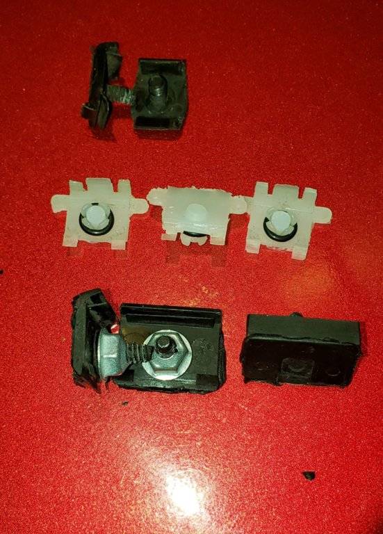

Here is what I currently have.
Here is a 4th lower style I have. Option 2 if you have some near perfect ones I could reproduce them, but not the wire metal type. Shoot me a PM if you are interested.

Here are the other 3 clips. From top to bottom: 6002123, 6024869 (acorn nut), 6002051, 6002049

Now I have to try to find replacements for the stud types. I may have enough usable ones with the stud in the middle, or substitute Mr.G #FA246. However, of the 6002123 parts with the stud at one end, I need 8 and at most I have 6 that I could clean-up and reuse.
I wonder if that could be made out of resin? I have urethane resins with different hardness. The stiffer resins could mimic the stiffness and slight flex of the metal.
Do you have a straight on shot of the 6002123 clip?

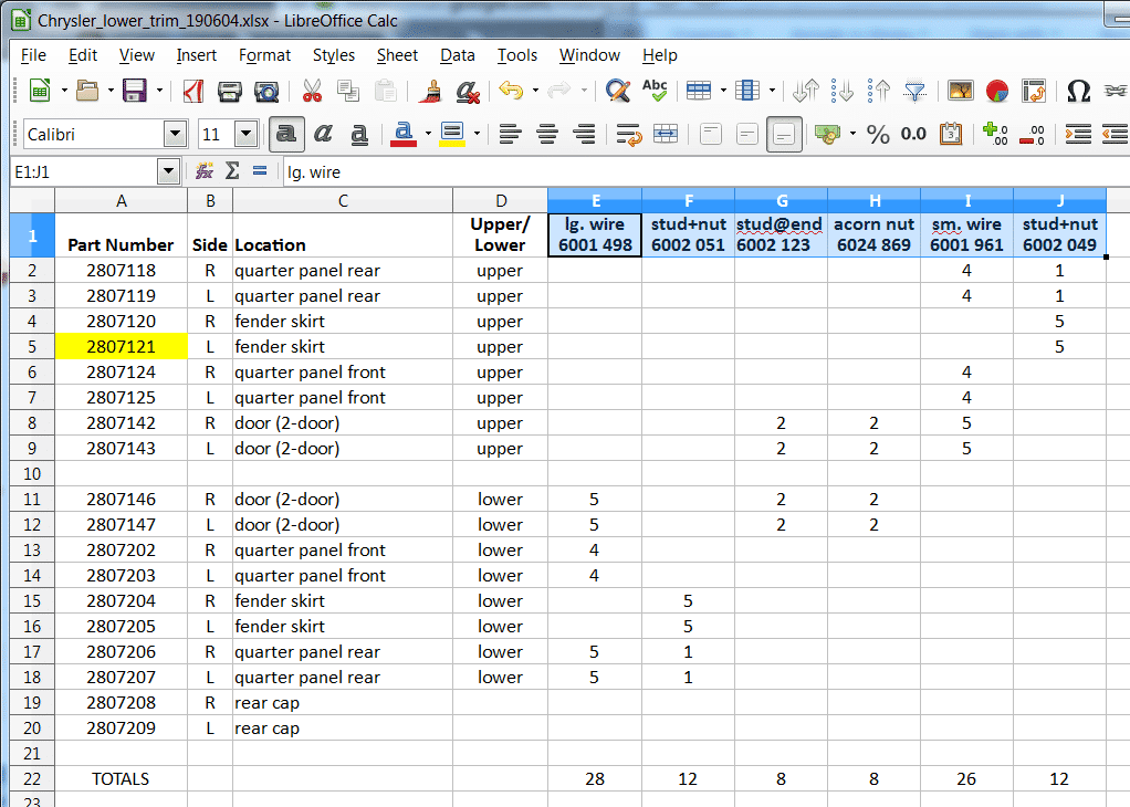

Mike that is a cool Excel spread sheet, I am guessing you made that up for your own car. Just in case you got it from an outside source, I would love to have it for other models and years.
Not at the moment. I'll have to take one. I have them soaking in Evaporust right now.
I made it myself to keep track of everything, from part numbers in the factory parts manual. I agree, it would be cool if such a thing was available for other applications.

The FA191 clips are larger than what they show in the picture. They don't quite fit in the trim, and the pinch-together part is a bit big for the body holes. They can be made to work by reshaping them with pliers.
The FA4323 are a loose fit because the wire diameter is smaller, and they may have been designed for a SMALLER body hole. Consequently the trim does not fit flush with the body in some spots. I should be able to get in behind the body panels to wedge some small wooden dowel or something to spread the clips so they pull in tighter.
I picked up NOS pieces of the upper door trim (2807142-3) which thankfully came with NOS clips including the 6002123. I also pirated some good used ones from a set of good 4-door doors that I have. Between them I have the 8 that I need. (I'll eventually need some more for my convertible though. Someone butchered the lower trim on that car.)
Further update: I gave up trying to make the FA191 clips work, and reused the best-looking used original clips that I had.
