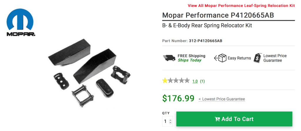

I installed the kit below in a 68 B-body. I don't know why it wouldn't work on a C-body, but I do know if there IS a reason why, you'll hear it here... LOL!

I am on the lookout for a Dana 60 because I'm building a stroker 440 and I know the 8.75 won't last long behind it. Also as I stated earlier I am putting a caltracs spring and bar setup in the rear so that will be covered. Maybe I will just look into the B body relocation kit and see if I can make it work.

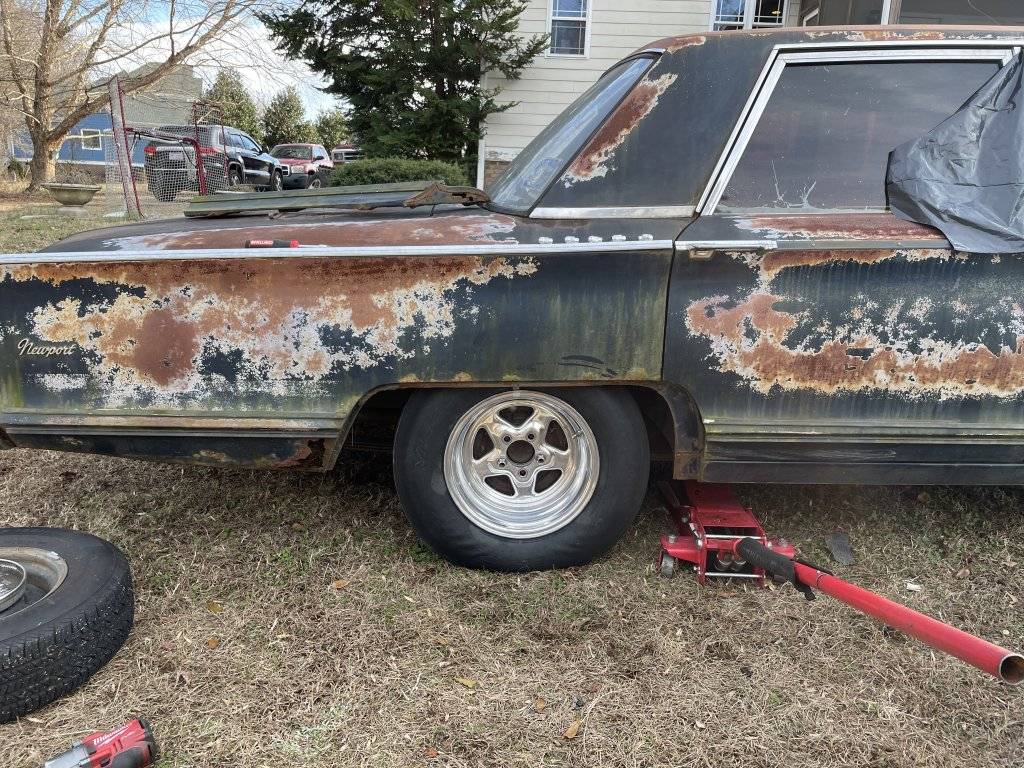

That’s not necessarily true. My 66 newport I fit an 11.5 with the side skirt. Never drove with them but they did clear. I have a set of Hoosier QuickTime Pro’s that have a 29x11.5r15 I’m putting on the car. Wheel spec makes a worlds difference.
What are the specs for that wheel?
