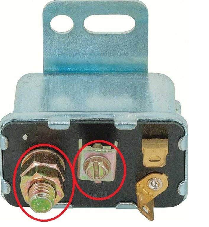

First is to check if the battery is charged. If it is, here's how you can check what the problem is. There is a starter relay mounted either on the firewall or inner fender. This is the next thing you are going to need to check. It looks like the picture.
See the two terminals circled in red? Take an old screwdriver and touch both those terminals. The engine should turn over. If it does, that is probably a bad relay, but there are other issues that could cause the problem. Try that and get back and tell us what happened and we can help you figure it out from there.

I did this manipulation and it's ok, the starter turns.

Great! That means the battery and cables are good.
The next thing to do is check the neutral safety switch. Since you have changed that, it makes me think to check that next. I've circled the terminal in yellow. Disconnect the wire attached to that terminal and use a test light or meter to check the continuity to ground when the car is in neutral or park. One side of the test light (or meter) is connected to 12 volts positive (+) and the other to the end of the wire. You should have continuity to ground. If you don't, the problem is the neutral switch or wire.

I connected the plus to the battery and the minus to the terminal wire circled in yellow, the lamp does not light up.

the car in parking position the light does not come on, however in neutral position the light comes on.

That means a problem with the neutral switch.
Ahh... I was just going to tell you to try moving the shifter.
You should be able to start the car in neutral.
So, it's either the neutral switch, or possibly the shifter linkage is off just enough to cause a problem.

Thank you very much. I just managed to restart it . I think the box rod is poorly adjusted.
