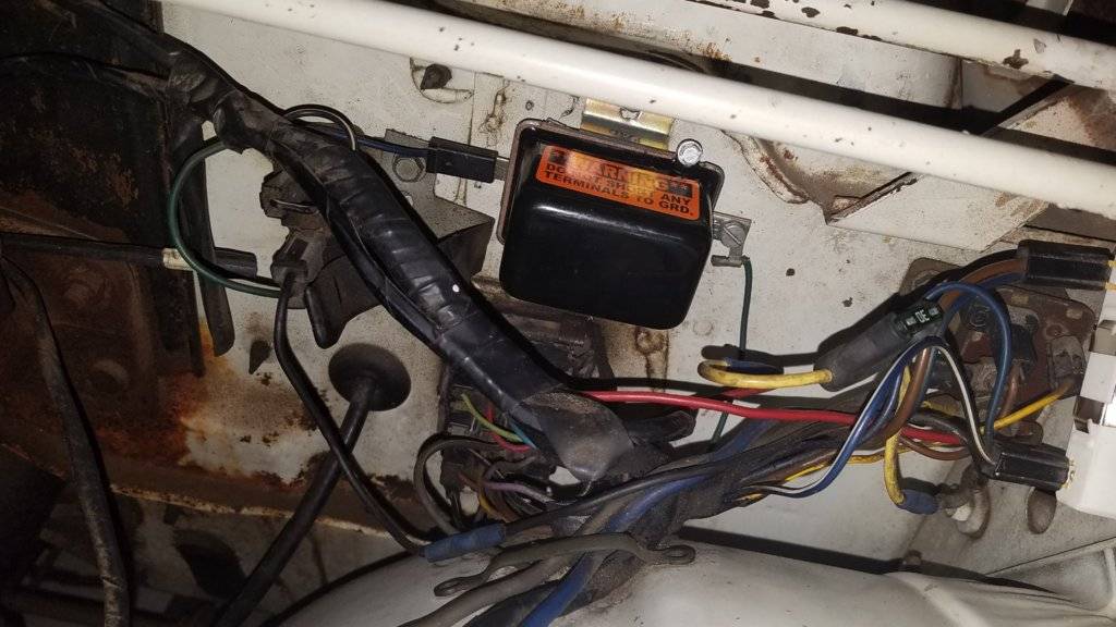

Dec 8, 2017 #1 FuryDan66 Active Member Joined Nov 17, 2017 Messages 364 Reaction score 105 Location Colorado 1966 Fury, is this the starter relay? Dan
Dec 8, 2017 #2 C Body Bob Old Man with a Hat Joined Apr 8, 2012 Messages 12,041 Reaction score 18,965 Location Youngsville, NC The one in the top photo is. The black one is the voltage regulator
Dec 8, 2017 #3 FuryDan66 Active Member Joined Nov 17, 2017 Messages 364 Reaction score 105 Location Colorado Yep knew that on the voltage , thanks C Body Bob ;) Dan
Dec 8, 2017 #4 Big_John Illegitimi non carborundum FCBO Gold Member Joined May 21, 2013 Messages 24,958 Reaction score 39,894 Location Marcellus, NY What is the 30 amp fuse for? Has someone wired that in there in place of a fusible link? The reason I ask is you are having some issues similar to a failed fusible link... Check the fuse.
Dec 8, 2017 #5 FuryDan66 Active Member Joined Nov 17, 2017 Messages 364 Reaction score 105 Location Colorado Yep fuse is good. All the connects seem to be okay.
