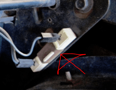

So I drove my car (65 New Yorker) to get breakfast this morning and everything was fine. I got back and washed it, then when I went to put it back in the garage she would start like normal, then immediately cut off when I let off of the key/put it in the run position. I tried it a few times and figured out that she will run if I hold the key just off of starter engagement. Obviously not good, but I was able to back it in the garage and she ran fine while doing so. I've never had a similar situation so where should I start looking?
Would that be the little guy on the right?

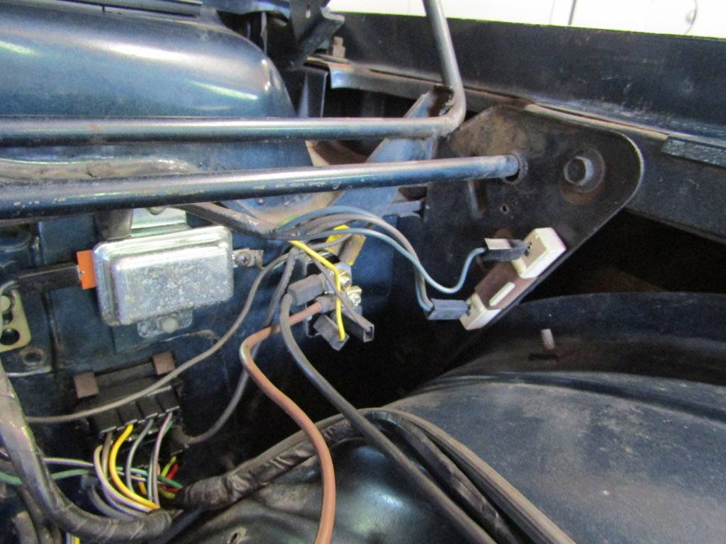

Gotta say, that's some clean and nice looking wiring under that hood.
Thanks. She's a known low mileage car (about 32K). I'm also pretty particular about how I take care of my cars/toys.
