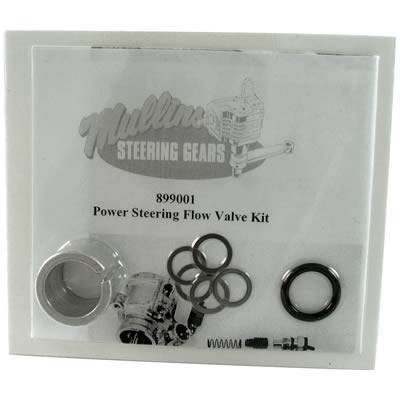

I did swap my Federal pump to a Saginaw on my 66 300. And yes the feel is a little firmer.
traintech55, changing just the steering pump firms up the steering - how does that work?
Rick Ehrenberg from Mopar Action had an article on this maybe three years ago. The Saginaw pump has different valveing than the federal pump, plus you can shim the Saginaw pump to make it harder.
I read up on the output psi of Federal vs Saginaw pumps. The early slant 6 Saginaw pumps put out a lower PSIs and were supposed to make it harder to turn C Bodies. Saginaw had different pump models with different PSI output for different front weight cars, and you can buy a shim kit for less than $20 or use washers to get that exact feel you like, and still be able to parallel park your beauty. Here is a link to the old article: http://www.forbbodiesonly.com/moparforum/showthread.php?35970-Saginaw P/S pump shimming for better feel Go to this article and click on link if PDF doesn't open automatically.
We put a rebuilt stock steering box in last week while we swapped a dual quad 440 into a 63 Sport Fury. It had the same big steering wheel, easy steering feel. It still has it. The Sport Fury will be the test mule for the Saginaw pump, and I will post what we find out here in a month or so. I'm a junk yard junkie and will use the cross reference from RockAuto to (hopefully) find some big block Saginaw brackets; otherwise they're available new on eBay.
This article shows the actual process for removing the Saginaw low pressure fitting and installing shims. Borgeson Pressure Adjusting Kit PN899001 has the holder so the fitting doesn't get warped, gouged or scratched, several shims and instructions for varying pressure. $16.97 from Summit and others. Go to www.hotrod.com/ (then finish with) how-to/transmission-drivetrain/1209sr-power-steering-pump/
