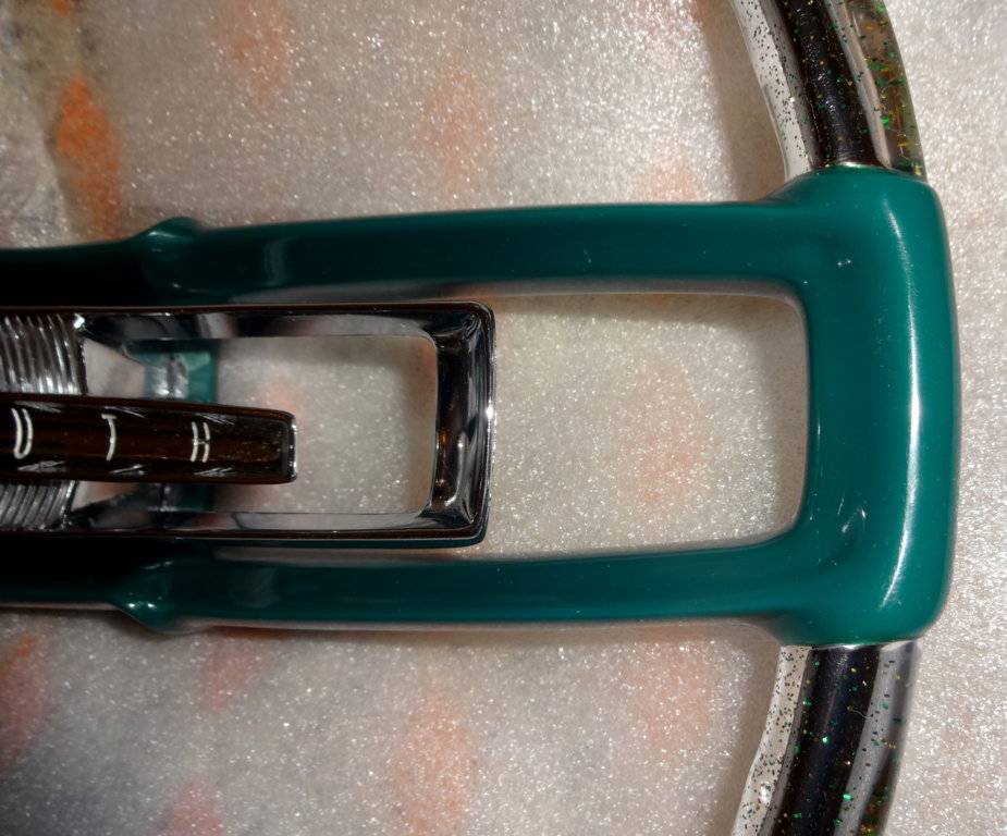

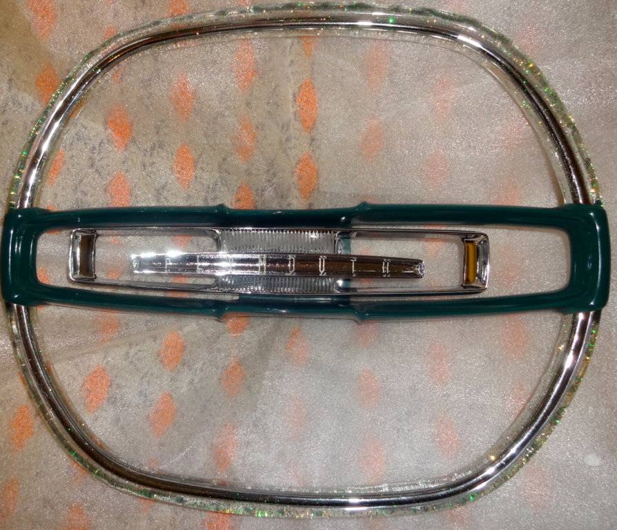

I had my 61 aero wheel recast at D & D in Mt. Airy NC. They sent samples chips of the center bar color and gave me the option of color flakes in the clear rim. I got to choose what I wanted. Because the center was a hunter green color I opted for green and gold flakes in the rim.

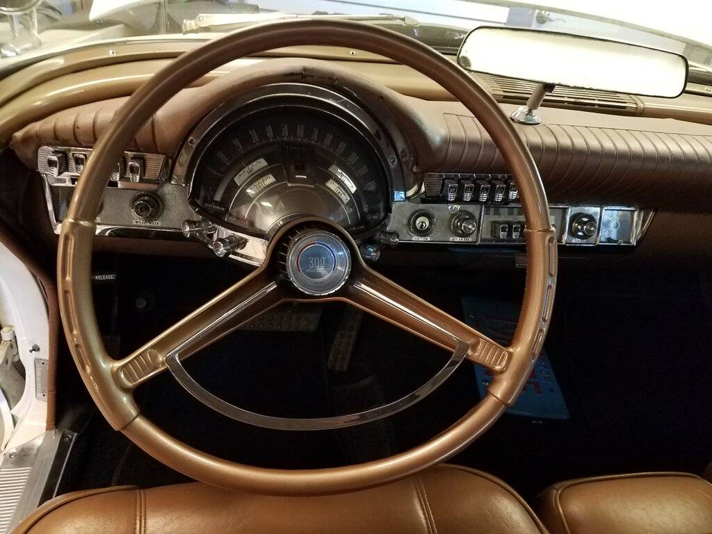

Steering wheels shouldn't be painted, IMO. They can chip or have the finish rubbed off as you are experiencing.
I don't agree exactly. If done correctly there is little chance of damage in normal use.
Painting with automotive grade base/clear coat is a good option for a driver that one doesn't want to invest a grand into a steering wheel. I've had very positive results with this method.

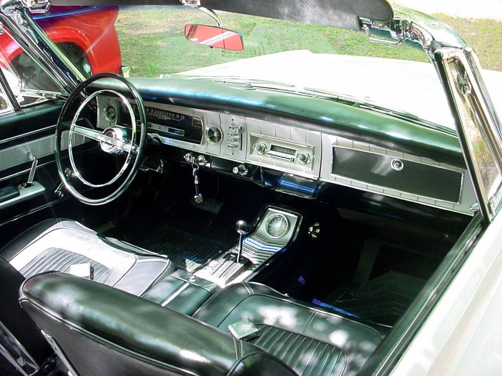

This is the steering wheel in my 65 Coronet 500 convertible, (since sold). My first experience with painting the wheel was with crylon rattle can. It looked great. Then one day, on the way to the beach Ellie gave some sun tan lotion which I rubbed on and drove off. Before we got to the beach the steering wheel was sticking to my hands.
I than stripped it and had a professional finish it with automotive grade base/clear. I drove that car another 20K miles and never had an issue.

Agree to disagree. Can it be done? Sure. Will it hold up in the long term? Not likely. The OP's car is not a driver. He's invested quite a bit of time and money in the restoration. For his application, IMO, the only way to go is to do it right: recast it. You spend ALL your time behind the wheel. When I look at it, I want to have the satisfaction knowing it was done properly and looks great.
Depends how you define driver. I put 2000 miles on it last summer and will probably be over 3,000 when I drive to Carlisle this summer. In my mind I built a new car that is correct for 1968 that I intend to drive. I cannot get my money back out by selling it. My satisfaction comes from the rebuilding, intimate knowledge about all systems and driving it.
A new cast wheel would be the ultimate, but that can always be a plan B later. First goal is to in-expensively touch up my current wheel.

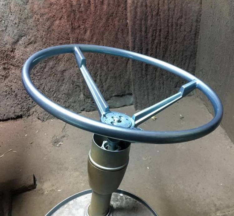

I painted mine w the help of these guys at least a year and a half ago. My wheel was bent cracked & broken. I wanted a wood grain but I’m still waiting to find a nice complete one on the cheep (around $200) side of things.
Anyways I used non Kalifornia enamel to change a nice green wheel to black. Clear will definitely pucker or lift the base color if you’re not careful. I did a good 4 or 5 mists of enamel then just a bit of clear for shine. When done it felt weird and I figured it probably wouldn’t last long. Turned out the final trick was to wax it. Once I did that it felt natural, smooth and not sticky. The wax really calmed down the painted surface and until I read this I forgot all about painting the wheel because it feels so NORMAL. I drive the heck out of this thing. Hot or cold weather etc etc, sweaty hands or oily hands it don’t seem to matter. Once you paint it and then wax it I’m thinking you’re good for many years to come. Mine hasn’t changed a bit since the day I waxed it. Just 2 cents worth from a guy who did it and so far has lived to tell the tale.
Look up “steering wheel helping hand” from back in 2018 for all the boring details. Good luck with the project.
