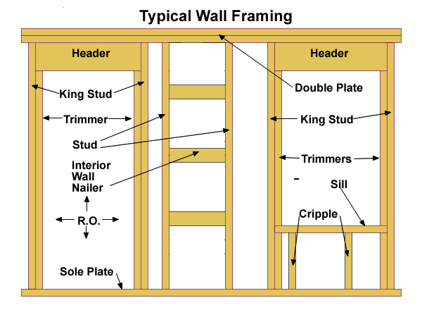

Below shows some basic framing .. The small header over the window is non load bearing...
Note the "silver clips" where the roof trusses meet the top of the wall, those are considered Hurricane clips and is what you would want to use to tie in your roof rafters to the top of your wall....
This was on google also, what they are calling a trimmer I am calling a Jack. I would double up on the Jack and King, two at each end, minimal.
The Sole plate is also called a bottom plate, obviously the one up top is called a top plate.....
