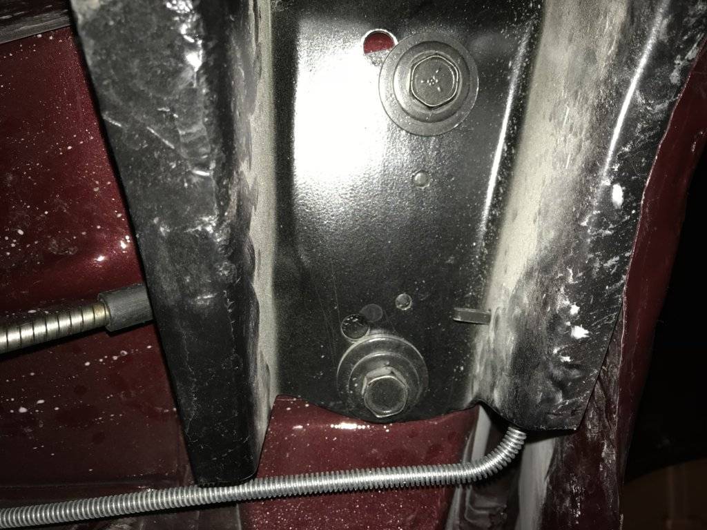

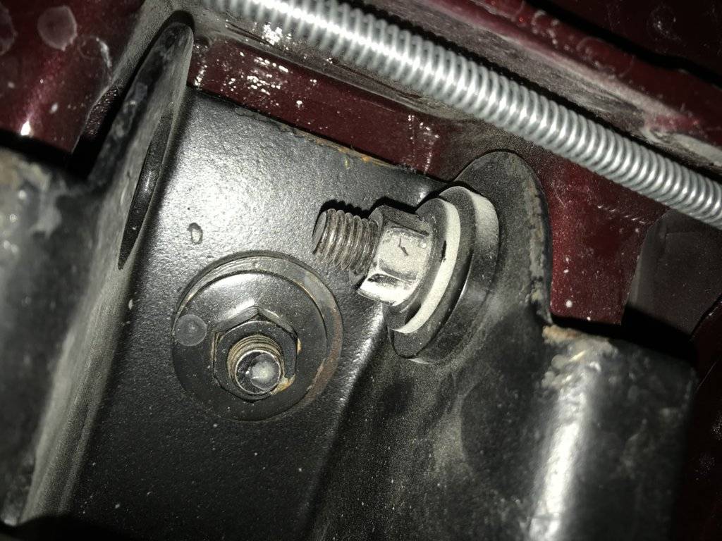

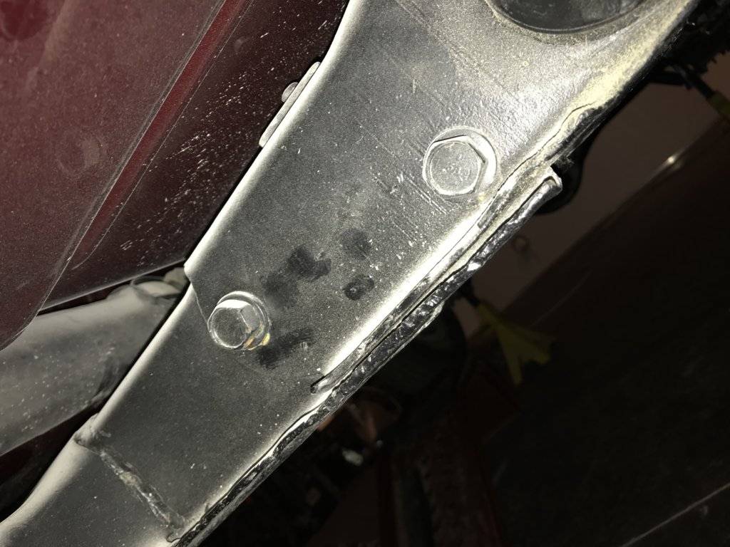

Pictures from a ‘68 Polara. Should be the same as yours.
If the nut on the bolt going through the floor is loose you will need to peel back your carpet to hold it.
These are at the end of your stub on left and right sides.
These are the pair that go up to the firewall/ cowl area. L and R sides.

Ok, I’m not going crazy... as clarified by your pics of your painfully clean stub frame and floors.
I’ve only pulled two stub frames in my life: one was a 69 Sport Fury and the other a 72 New Yorker. I have however looked at a good many and my 67 and 68 Monacos were just like yours... I was sure a 68 Fury would be the same with regards to the isolators.
