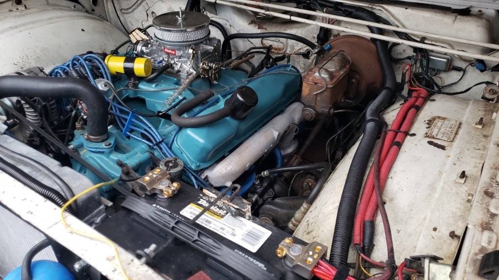

Hey Saylor, I installed the Summit 850005 in April of 2016. This is the only photo I found in my folder of how I wired it to the ballast. Looks like "dmac" provided the info you needed to get the EI hooked up. If you need more info I would have to go look under the hood this weekend. There were just a couple wires to connect, but since my memory is going south I'll just need to do a trace and it'll all come back. As you can see I installed the ECU on my fender.

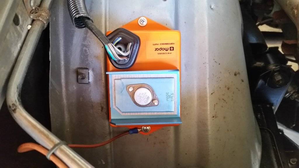

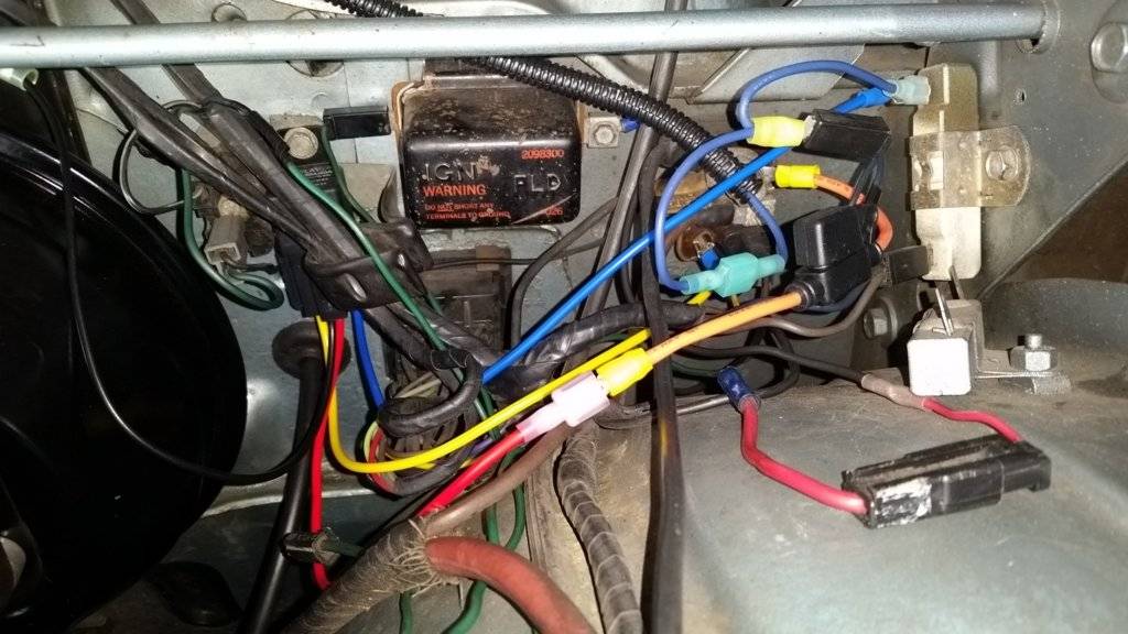

it really is only a couple of wires to hook up - i probably spent more time deciding where to mount the control module at. i ended up putting it up on the front inner firewall / radiator core support area up by the passenger side headlights:
so it wasnt far to the DIST from here. the ballast is the furthest thing away from here to wire in. but i guess it is cooler up here then on the back firewall ( in front of engine instead of behind it ) - a bunch of posts say these things get hot and melt the sealant goop out of them.
