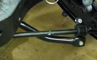

Yeah.. and those are missing on mine! Sway detail1.jpg I found some universal ones from Hotchkiss but.. 40 bucks for some Metal with a hole in it... idk...
Unfortunately I dont have the space or tools to fabricate them :(. Welding them on would be ok tho.

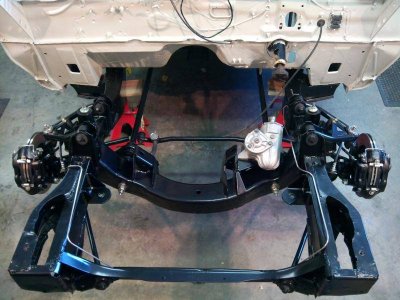

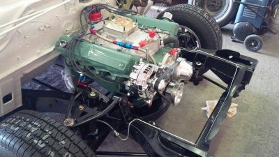

Check with Firmfeel. I bought their swaybar but I had a factory one. I think I remember they saying they had the brackets if you didnt have them. I like the firmfeel as it comes with the other brackets that you drill into the lower control arms. I think makes it handle much better then connecting to the radial rods or what ever those are called.
No matter what you decide to do, I couldn't be happier with how my front suspension turned out. It far exceeded my expectations, dare I say my 300 carves the corners now. I feel the sway bar is a big part of this handling.

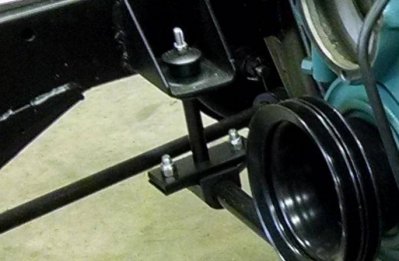

These brackets and sway bar came from firmfeel but the sway bar isnt mounted yet. I just placed the bar where it would attach to the lca to find the location for the brackets.
1Fury1, which brand are the upper tubular control arms?
Sorry for the late response I seem to only get here a couple times a week. The tubular upper control arms are also Firm Feel, as are the tie rods, idler arm, torsion bars, shocks, rear leaf springs
