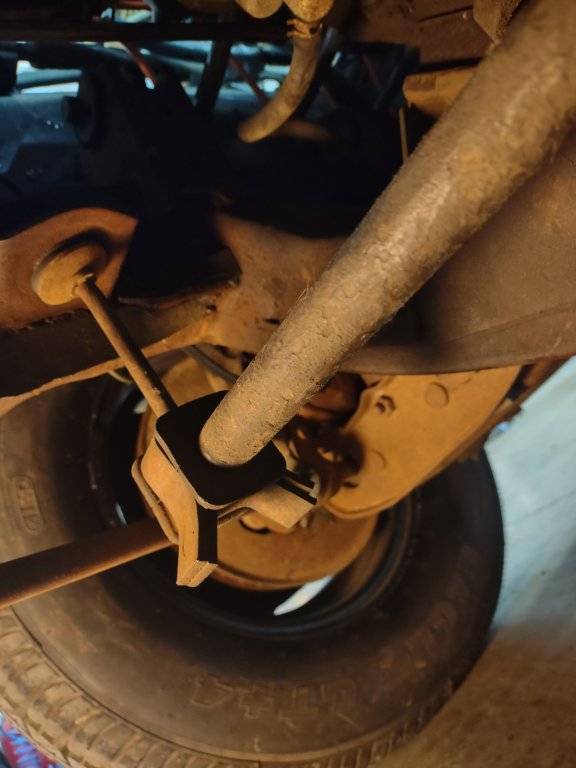

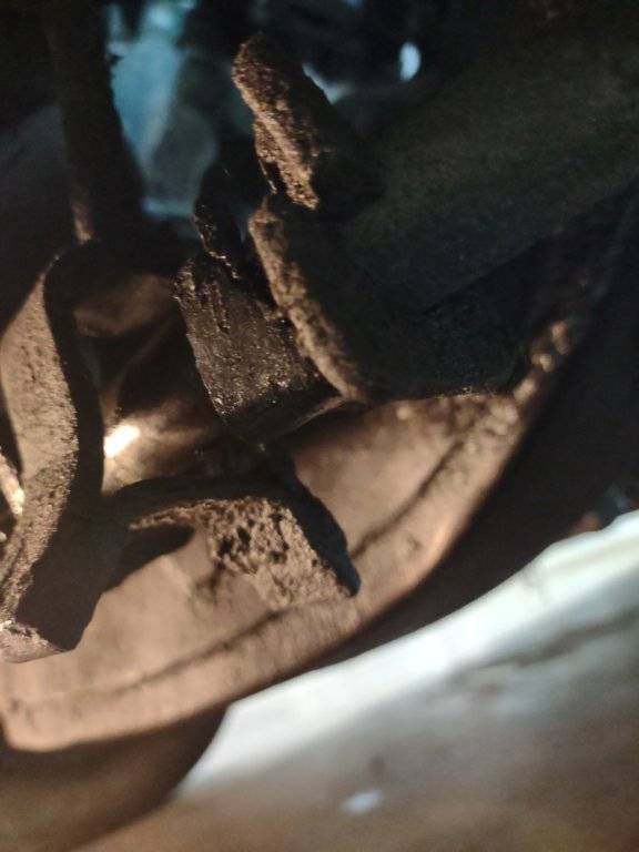

Well seems the 300 is a strange animal. My stabilizer link bushings are bad, however, nothing i looked at seems right. Even the FSM shows and says to unbolt the bracket to replace the bushings but mine have no bolts. Its two pieces welded together. Looks factory.
Good right side, bad left side
What you have is factory for C-bodies. From about 1965 - 1973, IIRC. If you can get a new bushing, slice it with a razor blade (if it's not already sliced), then slide it into place, using some silicone (or similar) on the horizontal slice. Or drill the spot welds as mentioned.
Im amazed at the quality back then. 54 years and the right bushing shows no wear. The left was damaged by years of steering leak on it.
