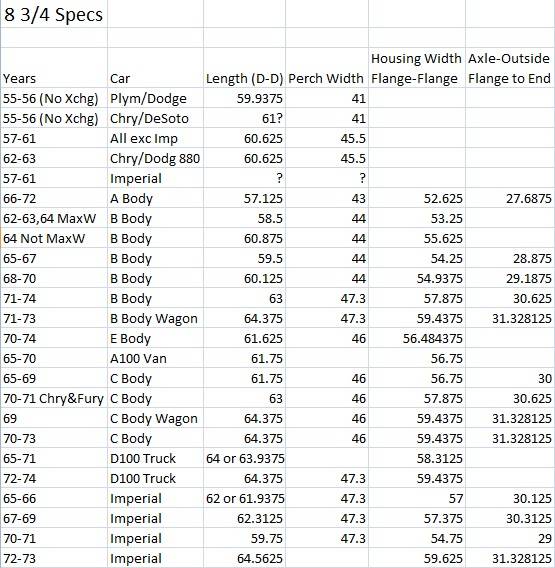

The easiest and cheapest way to address this would be change out the whole housing for a later complete unit. One of the custom axles if even available to convert you existing setup will probably cost as much as a used 8.75" in the later style. Going that route you might have to change the differential yoke to match your current drive line. The 65-69 C body should have the same spring pad width.
Dave
I replaced the rear axle in my '63 Chrysler 300J with one out of a '67 Plymouth VIP. The spring pad centers were about 1/2" wider than the '63. I modified the center pin holes on the pads to match. I used the original '63 backing plates by boring the center hole out to the same size as the '67 axle bearing. That allowed me to keep the original 11 X 3" brakes and still have the adjustable bearings. The original drums pilot nicely on the later axles and everything fits and works well. The inner u-bolts lean in towards the center and a couple of wedge washers took care of that.
Earlier center section (pumpkin) have different length axles on open and sure grip rears. If you have a sure grip in it now with tapered axles it's the same as all later axles. The early open rears had longer axles ( smaller spacer in center)
It sounds as though Dr. Diff and Strange can both make the axles needed to upgrade from the tapered ones for a few hundred bucks. I just have to do a bunch of measuring. I didn't want to have to remove the entire housing, make sure the driveshaft yolk aligns properly, etc., if all I was upgrading was the axles (and some rear brake equipment).
