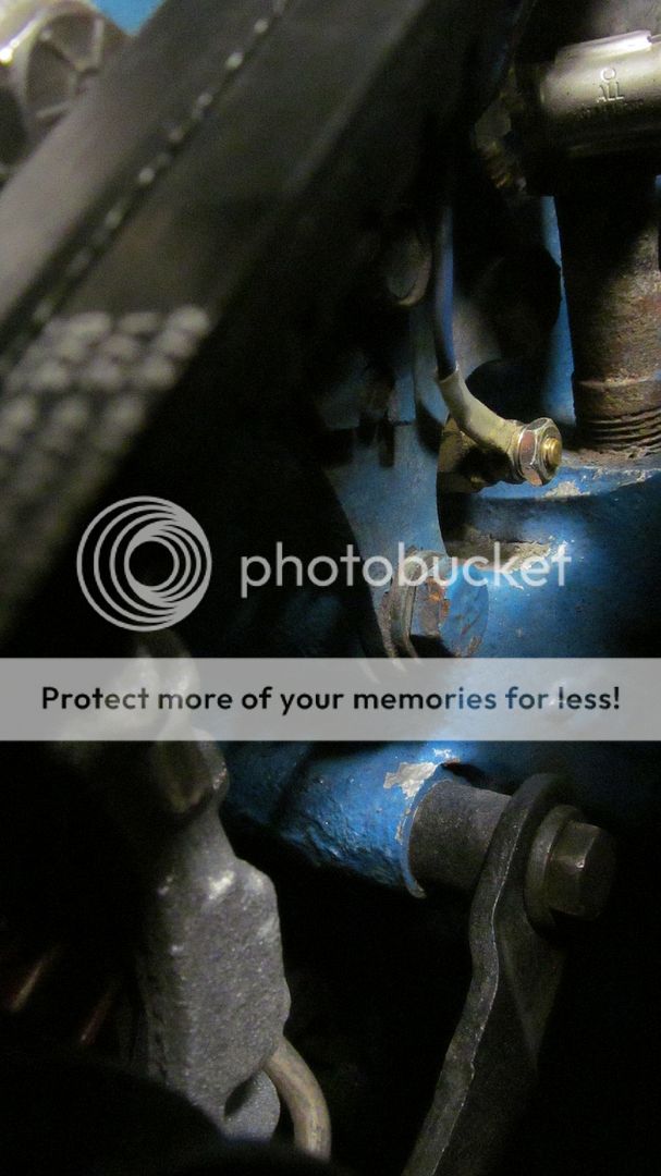

Hard to see, but I drilled and tapped the 1/8 port with a 3/8 npt. I don't think it will work if you have a/c.

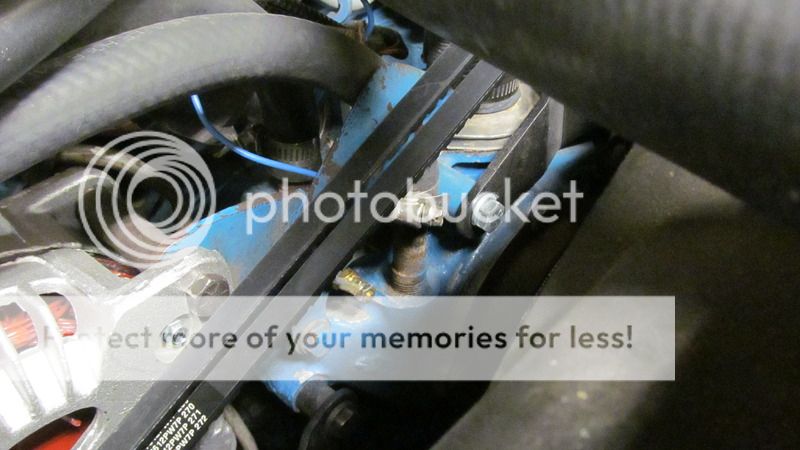

This is what I did on my 70 300.
I installed the sender for my electric temperature gauge here.

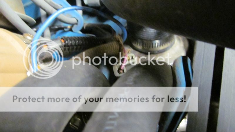

There's a plug next to the heater hose. You just have to remove it and it's a standard pipe thread.
The sender for the hot/cold lights stays right were it is.

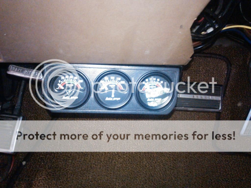

The gauges are Autometer. One of their inexpensive Autogage line. All are electric making the hookups easier than mechanical gauges.
They were mounted under the dash, just left of the opening for the steering column.

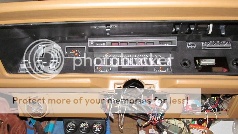

A better pic when the dash was out of the car.

Does your left leg ever hit those gauges? Also, are they not hard to see in that location? That's a problem with our dash; it's so low that under-dash gauges are really low. I have water temp and oil pressure gauges; my idea is to mount them on the empty plate next to the radio. Yes, I would "destroy" that area of the dash but they would be in a great location, in my opinion.
My leg doesn't hit them and I'm 6'2".
It's not exactly in the line of sight, but it's still easy to see. Since the hot/cold and oil pressure lights along with the ammeter are still functional, I regard those gauges as backup to the warning lights.
