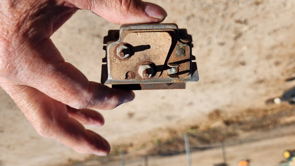

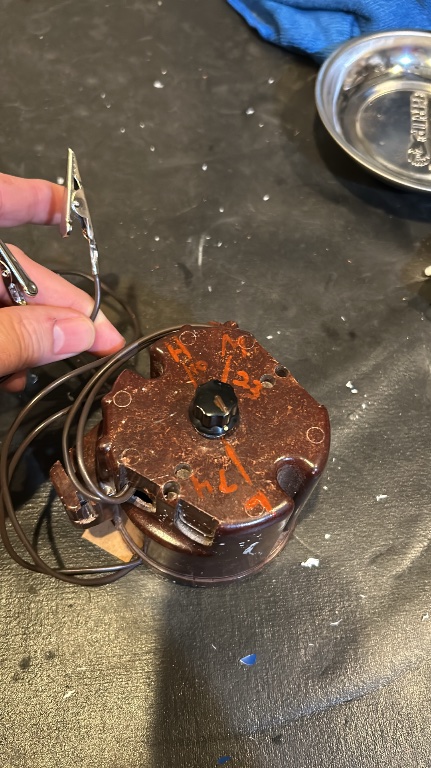

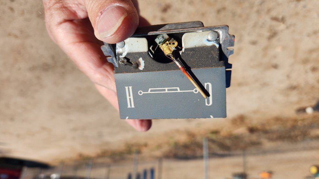

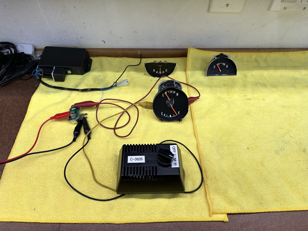

Any way to accurately bench test this gauge?
Depending on the year, 5 volt power supply with a decade resistor box is the ultimate answer, but to see if it works, a 5 volt source and then ground the "s" terminal will do it.
The 5 volt power supply can be sourced from an old desktop computer. Look on YouTube for how to make one. Taking it further, the decade box is a little specialized, but I found this a while back and it looks pretty good. Under $30!
View attachment 744588View attachment 744589

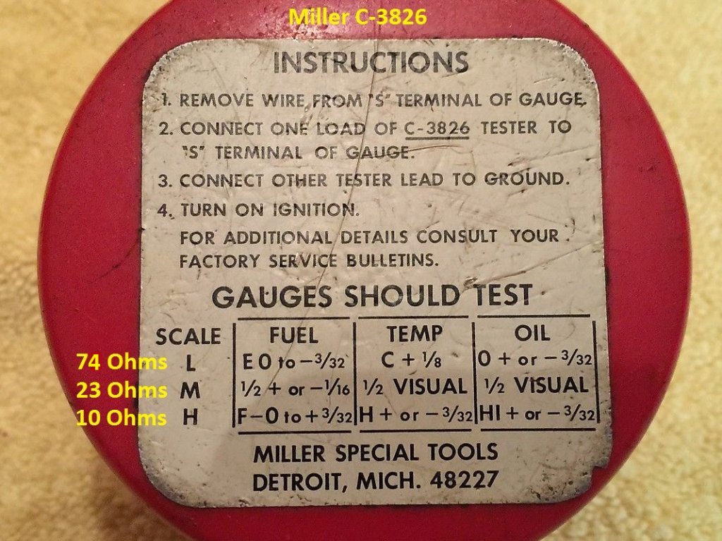

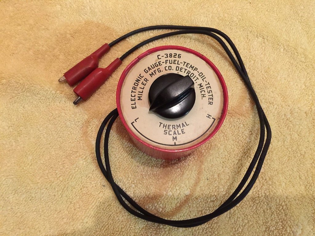

The gauge can be bench tested with a 5 volt DC power source and select resistance values or the Miller C-3826 gauge tester.

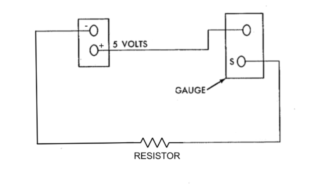

Set up a circuit as shown in the following diagram:
To check cardinal points of the gauge, do one of the following:
Using resistors
Point resistances can be made using fixed resistors or a combination thereof, variable resistors, or decade resistance boxes.
To check points of the gauge, use the following resistance values:
Chrysler Specification:
Cold = 72 Ω
Middle = 22 Ω
Hot = 9 Ω
Miller Special Tool Specification (used by Chrysler for testing):
Cold = 75 Ω +/-5% -> 71.2 - 75.8 Ω
Middle = 22 Ω +/-5% -> 20.9 - 23.1 Ω
Hot = 10 Ω +/-5% -> 9.5 - 10.5 Ω
Gauge position tolerance at these points is listed in the service manual, but in general, observe the following:
  1. With the 9 Ω resistor, observe "Hot or H" plus or minus 3/32" on the gauge.
  2. With the 22 Ω resistor, observe the gauge to slowly advance to ½ position.
  3. With the 72 Ω resistor, observe "Cold or C" plus or minus 3/32" on the gauge.
Using the Miller C-3826 tester:
The Miller C-3826 tester can be used to test these points. If using the Miller tester, substitute it in place of the resistor on the diagram.
Gauge position tolerance at the test points is listed in the service manual, but in general, observe the following:
  1. With the gauge tester on "H,", observe "Hot or H" plus or minus 3/32" on the gauge.
  2. With the gauge tester on "M", observe the gauge to slowly advance to ½ position.
  3. With the gauge tester on "L", observe "Cold or C" plus or minus 3/32" on the gauge.

If you seek a variable resistor of the same range, get a fuel sender, wire it to this gauge, and run the float up and down. The resistances will be the same as your temp gauge, so you should see the needle deflect over the same values. After all, those fuel senders were just crude pots. 4 Rechargeable NiCD C or AA cells will get you 4.8 VDC, when charged. A USB power supply will give you 5 VDC, but get one with some decent ampacity, lest you burn it out on that paleolithic sort of load! :)
My home built tester. A pot from Amazon and an old fiberglass electrical box.
Use with a 5 volt power supply.
10 Ohm High or full. 23 Ohms Med or 1/2 full. 74 Ohms Low or empty.
