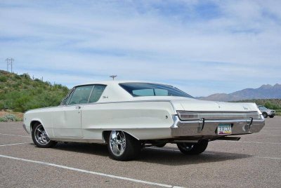

Not to get off topic but you have a very nice car welcome.
And noticed the huge dent in the drivers door how did that happen?
