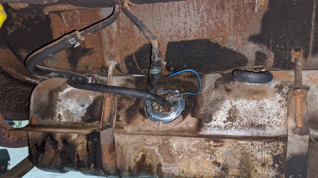

Had a constant fuel leak around the vent tubes and locking ring, I replaced all the hoses and pulled the smog canister as it was full of fuel anyway. Crazy how many vents there are on these tanks...I wonder if it's a CA car originally?
Also, I think I've clocked the sender wrong as it's reading just under half buts it's full to over flowing, does anyone have a pic of their sender sitting properly in the tank?
