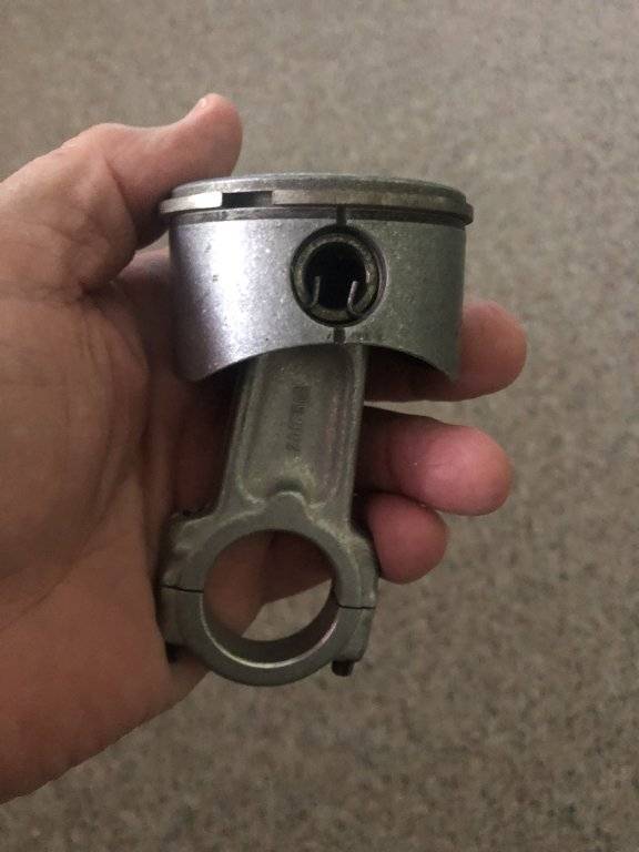

Well, I pulled a vacuum on the system. It held, I dropped my gauges so the number didn't read 28 inches but it held steady at 25. I put two cans of r134 in it. It was dead empty, I pushed both high and low side valves to see if there was anything left in the system. The clutch engaged as it should. The needles equalized at 200 I think. Zero cold on the low side line and of course nothing but hot air out of the vents. My thought was either rings, which i have found with new piston and rods, or reed valves. Seems silly to replace one without the other. However the reed valves, when replaced, would let me know if the bottom end is any good. Or so goes my thinking.....
