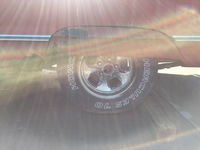

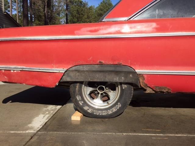

Also found the fender skirts To he '66. One original to the car and the 2nd is blue. Both in great shape.

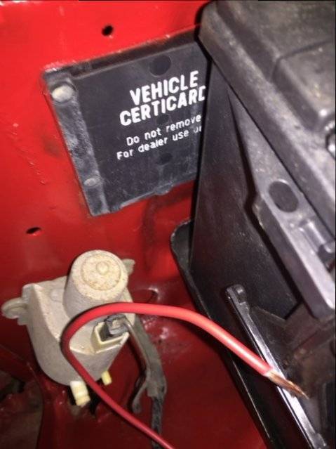

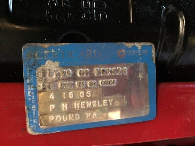

Started prepping for the motor pull by unbolting the exhaust and driveshaft. very cool that I found the Certicard. My wife and I spent some time searching for the original owner. I think I found him. More to come on that part.

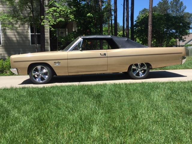

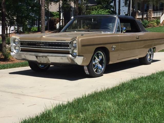

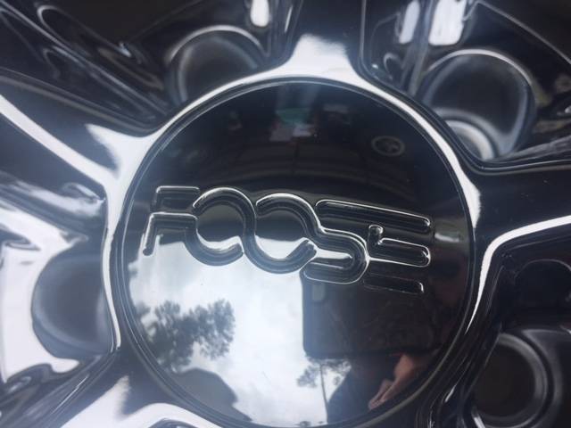

Installed the new wheels and tires. I went with Foose 18" wheels with the rear being wider and Cooper tires. Tires are same height as stock but much wider. A buddy is coming over this Saturday to help with the engine / trans swap. Now the fun begins. Exhaust shop will come in to play next week.
Also ordered a vanity plate for it along with one for my Jeep Scrambler. After owing 37 vehicles in my lifetime this will be the first time I have ever paid extra for a vanity plate.
Foose wheels =
18x8 front with 225/5018 Cooper ZEON tires
18x9 rear with 255/45/18 Cooper ZEON tires

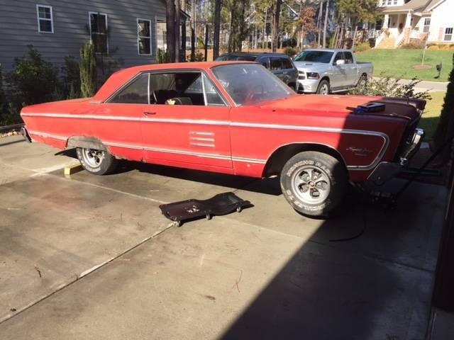

Just realized I didn't provide an update on what happened to the '66. I couldn't bring myself to sell it as a driving vehicle due to the condition. The pics made it look 100x better than it was. From the back of the doors to the rear bumper was swiss cheese with I don't know how many pounds of bondo. The sub-frame had patches on top of patches on top of patches. The thought of someone driving that thing on the street scared me.
-I sold the 318 and 904 to a guy building an old 30s Dodge 4-door.
-Stripped the interior and sold it to a local guy wanting to turn his '66 Fury I into a Sport.
-Sold the carcass to a local body shop who have plans to build it into a vintage drag car. Last I heard they had done quite a bit of work on it already building an entirely new sub-frame and starting on a motor.
For me this was the best plan to use the '66 versus scraping it yet trying to keep everyone safe. I sleep better at night at least.
