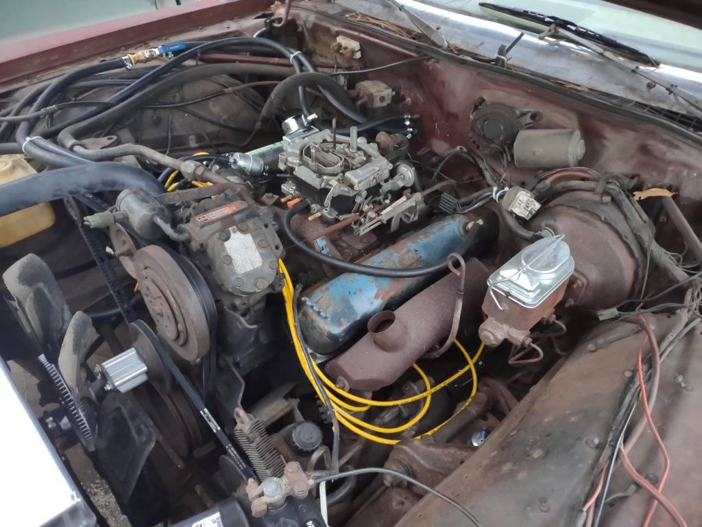

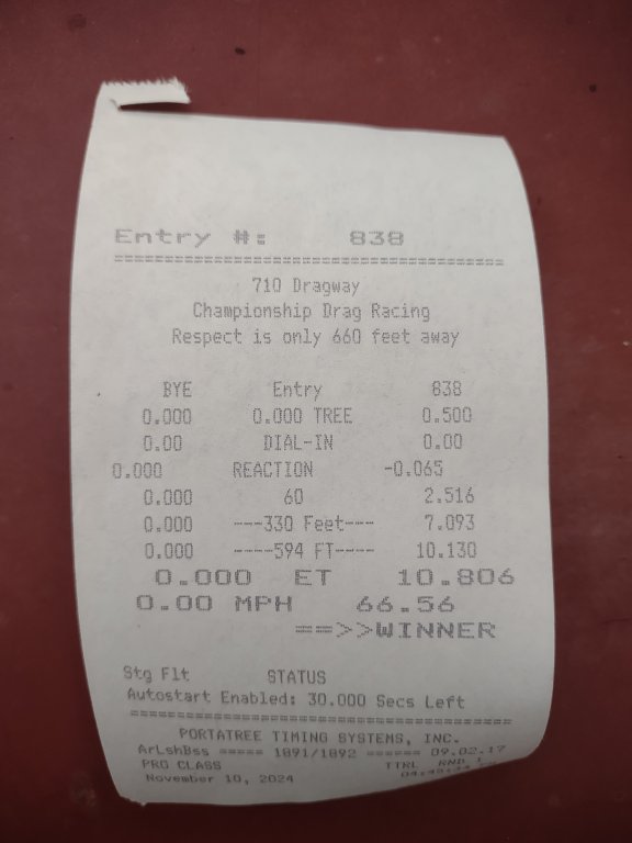

I put the thermoquad that I've been super-tuning for my 318 on the car after I got the bugs out of it and it woke it up big time, it loves the 400 engine even though it's an '81 small block carb. I also changed the old plugs and wires for solid core accels and non resistor J12YC champion plugs. It picked up a whole MPH and almost 2 tenths over the holley, granted it was at a different track in a different day with better ignition but still. And the sound it makes when the back barrels open put a permanent smile on my face.
