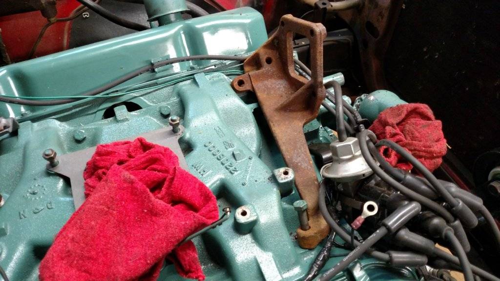

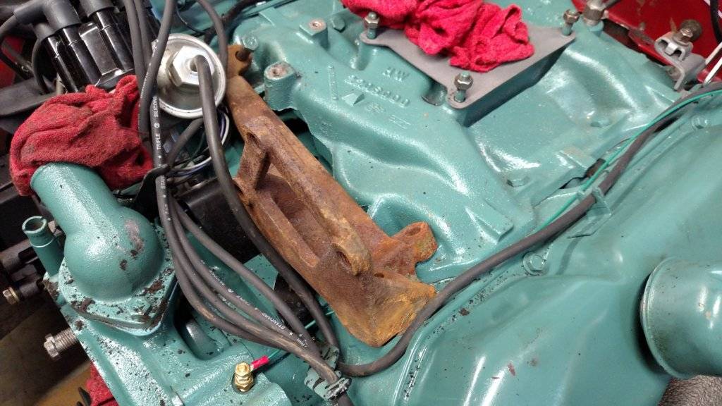

Here is the 440 bracket I received from Murray. Fits perfectly.
As you can see, the two brackets are quite different.

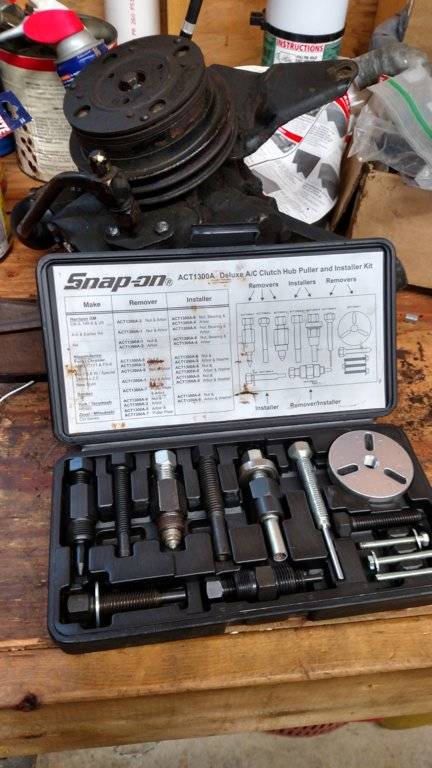

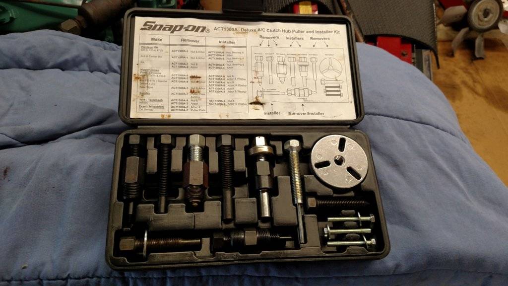

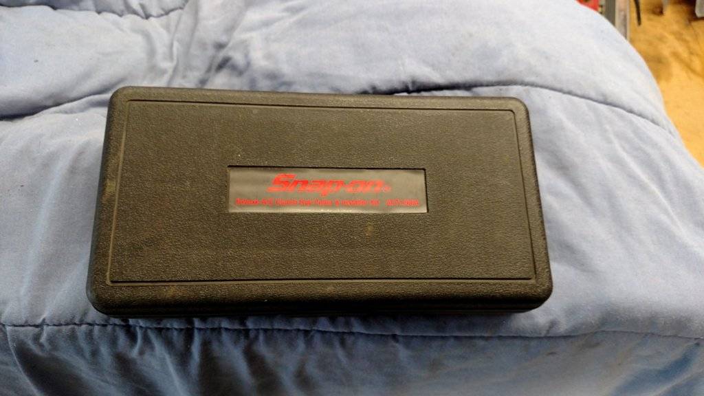

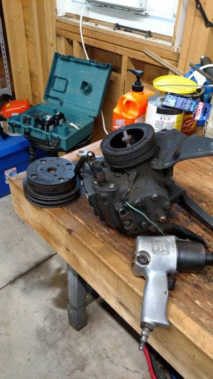

During my quest for a clutch hub puller, I found an E-Pay ad that had one more day to go. It was for a Snap-On puller kit, and the current bid was $32.00. I put in my max bid, and won the auction for $42.50. I tried the tap-tap of the hub to get it to fall off in my crotch or on my foot, but I got no where with that technique. . .
As you can see, the puller kit came with few directions, so it took a while to figure out which arbor and nut to use.
But in the end, I figured it out. . . And VIOLA!

Great find on the puller, looks like a high quality piece. You are correct the brackets are quite different in length. I can definitely see how you wouldn't have realized the difference until you installed them, because of their similarities.
Thank you sir for the pic's:thumbsup: do you have it painted yet??? By the way you stole the puller set for $42.50. I don't remember what my boss paid when he got the same set a few years back, but I know for sure it wasn't that cheap.
I found the new set from Snap on, it has one other tool to hold the pulley, but you get the idea on the price. I am sure it would be higher if it came off the truck rather then ordering direct from Snap on
Kit, Puller/Installer, Air Conditioning
Thanks for the info. Before I put in a bid on Snap-On puller, I checked all the similar Chinese kits on Amazon and elsewhere. They looked like a good deal, but the reviews indicated poor quality. Someone once told me: "Always buy the best. You will never be unhappy with it." I'm just really glad I got the Snap-On puller for about the same price as the el cheapos.
If your truck is charging you more, you have a greedy franchisee... in order to not damage the franchises, Snap On doesn't undercut them online or offer promotions through the website.
It's a good tool for keeping the truck honest, unfortunately there have been minor deviations in published pricing. I have heard of dealers adding percentages to the pricing, sometimes to get more out of high risk customers... sometimes across the board to pad their bottom line. This is not approved behavior, but IDK how much they audit for this.
I suspect that is a MasterCool set... Snappy can't make everything they sell. IMO it is still top quality and a very good deal.
