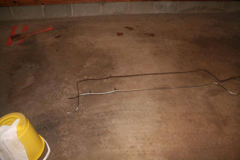

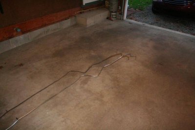

Since the last update I installed the new fuel lines. Pulling the wire through the front stub frame when I took out the old line worked like a charm to install the new one. The rear one took a little bit of adjusting. Man, steel line is a lot hard than Ni-Copp to work with.

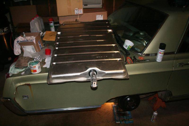

The new tank before install.
I had three helpers when it came time to put the new tank in; ages 3, 5, and 7. I bet it would have been funny to watch. Seriously, they were a great deal of help. The 3 year old held the license plate bracket down out of the way of the filler neck. One of them ran the jack to lift the tank up and the other was holding the light and handing me tools. (Side note: The mount for the fuel gauge wire had metric threads. What is it with people putting metric threads on parts for old American steel, ugh.)

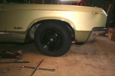

Well, I finally had a chance to pull it in and fit up the new wheels and tires. Nothing fancy just a set of 15x7 with some Cooper Cobra GT’s in 255/60R15. They fit fine and turn lock to lock up front without any interference. I was pretty confident that they would work since that was what I remembered having on my car 20 years ago. There is lots of room to spare. I guess I don’t understand why the engineers made the wheel wells so big when they weren’t putting that big of a tire on the car. Oh, well it works out for us putting bigger tires on our cars.

I believe they were putting that much room under there for body roll and suspension movement
