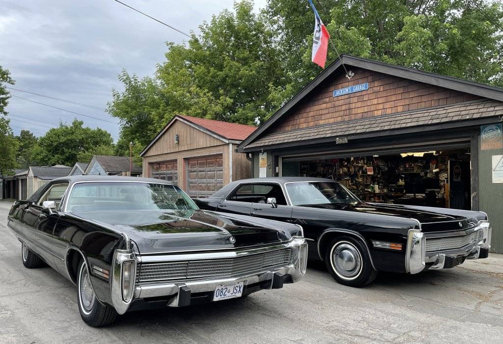

Couple of beautiful more doors you have there! Love the shop, those garages go on forever, like a garage condo! I am with Rip on this one, as mentioned in a much earlier thread on tires, IMHO, cars from the 60's and 70's look really good with the narrow whitewalls, the fat white walls seem to lean more to the 50's look, but that is a personal preference. To Rsbolin, with such low miles on the car, why the gas tank replacement? Did it suffer a catastrophic injury at some point? CamShaft

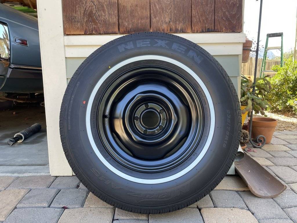

I say go for the Nexen AH5 235/75r15 WW. I am going to be picking up another set shortly for TB. Tux is already riding the NEXEN

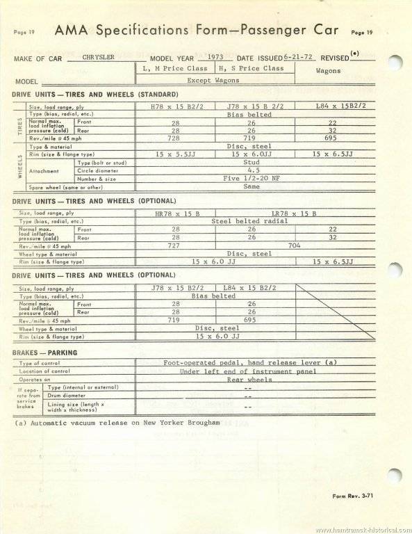

My rims should be 6.5" yours should be 6" I would not sweat it. The 235 will be just fine on your car and look great.
The 235 revs per mile are 723. Your car could have been 704 RPM for the LR78x15 or 719 for the J78x15.
