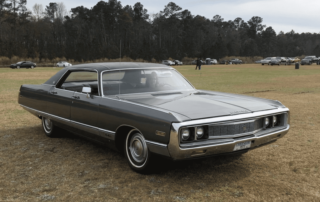

    I've had Mastercraft P235/75R15's on my 71 NYer for 6 years now, with 4000 miles on them. Several long trips (200 miles) at highway speeds. No complaints. Smooth, quiet, and handles well. At the time, these were the only readily available tires in my area. Looking at Cooper and Hankook for my next project. Screen Shot 2019-04-22 at 1.09.15 PM.png

    Thumbs up for Cooper Trendsetter SE tires (235/75R15, 3/4`` white stripe) from me. :thumbsup:
    Beautiful Ny´er, BTW.

    Really, really like your NYer. Beautiful car! Would love to hear/see more about it. How about a dedicated thread?
    PS: If you’ve had the tires for 6 years, I’d consider new ones. FWIW, I generally replace tires after 5-6 years regardless of mileage. Even if you wait longer, the fact that the Hankooks H724 will soon be gone from retail channels might prompt you to move faster than you would have otherwise. Just my two cents of course, it’s your money and your risk aversion.

    There are different schools of thought on tire replacement, I know. Between 6 and 10 years of age, variables come into play. At 10- yes! replace regardless ! (industry standard). In my case- car is garage kept, thus sunlight exposure is minimal. Ozone exposure can't be avoided, however (which is the ultimate age factor in tires). Mine are supple and sidewall crack-free, thus I will push them for a few more miles. :thumbsup:

    I've received a few compliments on my car on various posts on Cbodies, and appreciate them all! I will get around to posting a "garage" for this car. Thanks!
