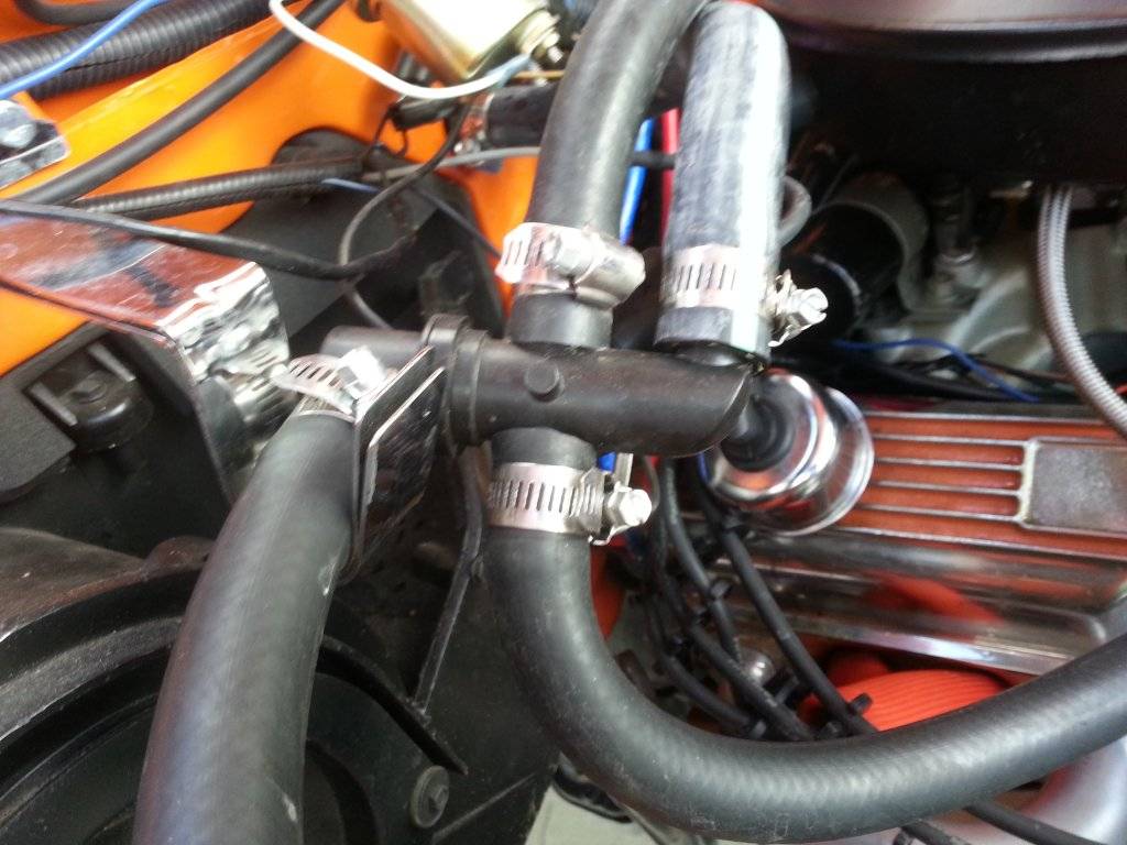

I use one that looks like this. Just google "heater hose shutoff valves".

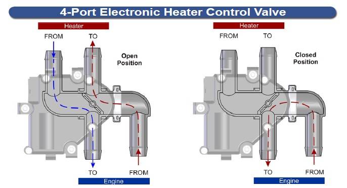

Consider installing a 4 port heater control valve. They can be found on Chrysler and Mitsubishi products from late 80's and early 90's. Unlike the original valve which is just a stop these actually divert water back to the cooling system when the heater is not in use. Uses the original vacuum line for control.
Here is a diagram of the flow open and closed. This unit is electrical but it is the same principal for the vacuum controlled unit.

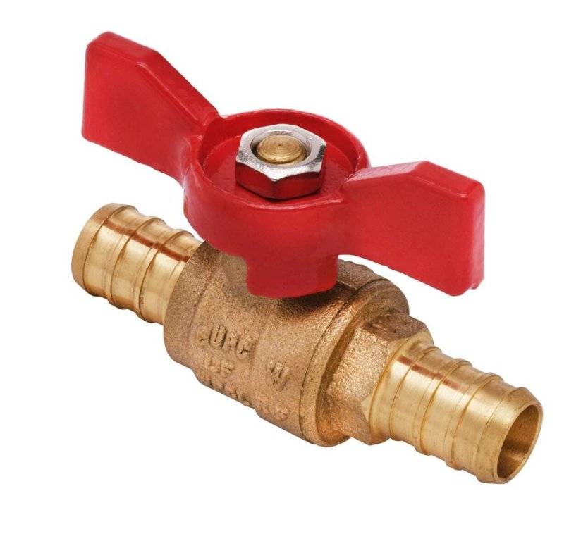

I use a hardware store PEX valve. 3/4 inch. They use them for plastic pipe home plumbing.
3/4 inch per is a perfect fit in 5/8 heater hose.

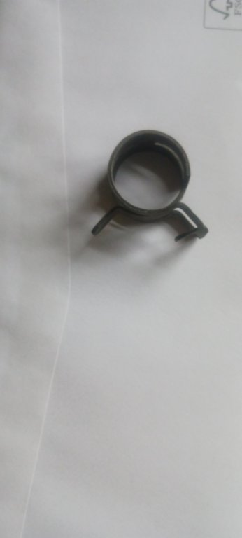

Paint the valve black and use a clamp like this also painted black. This clamp is off a Dakota aprox 1988, I'd expect it it common on all mopars

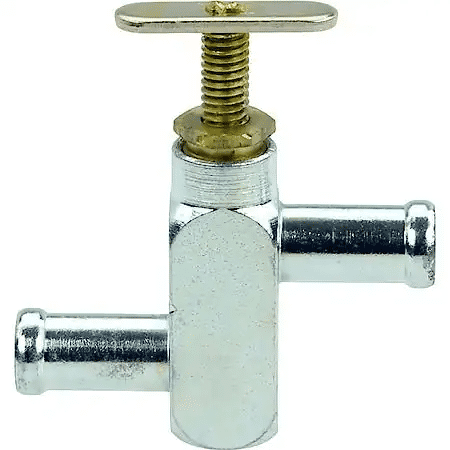

I don't have a picture of the valve but I get the more compact one. I'll see about a picture of the valve
