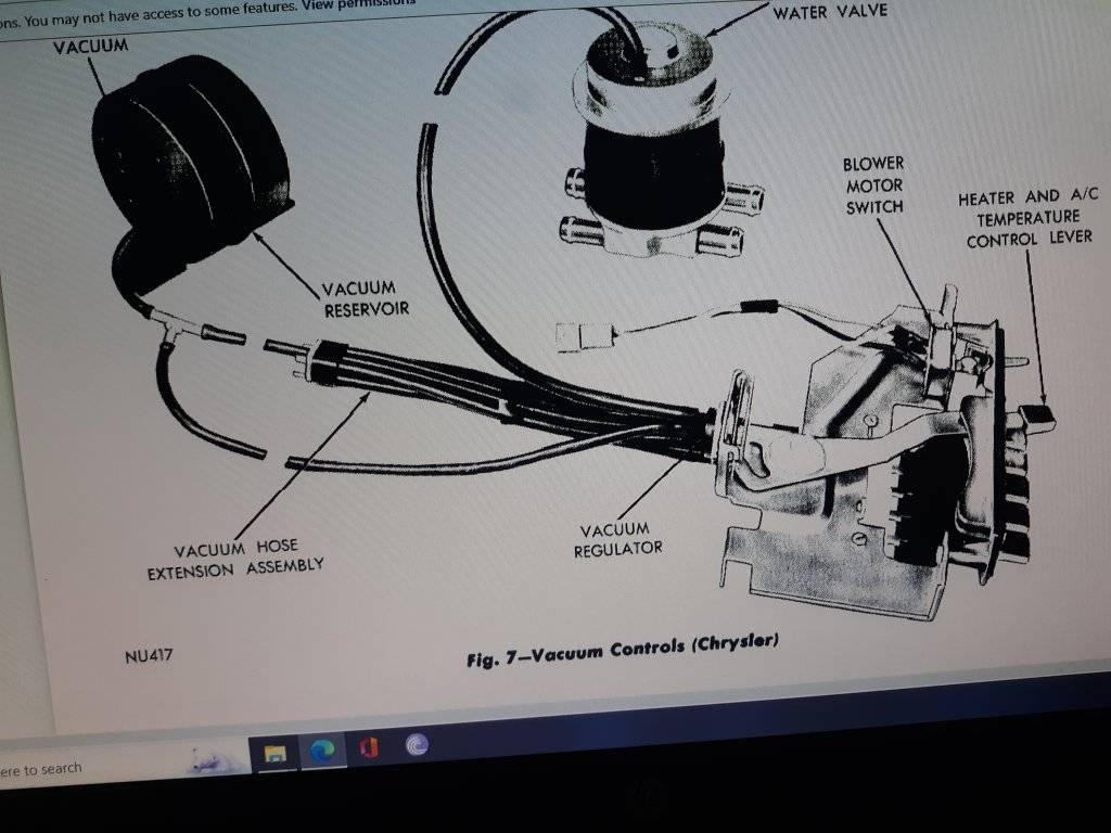

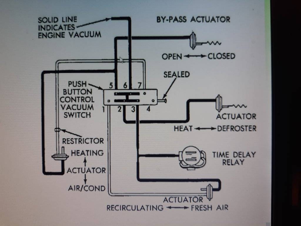

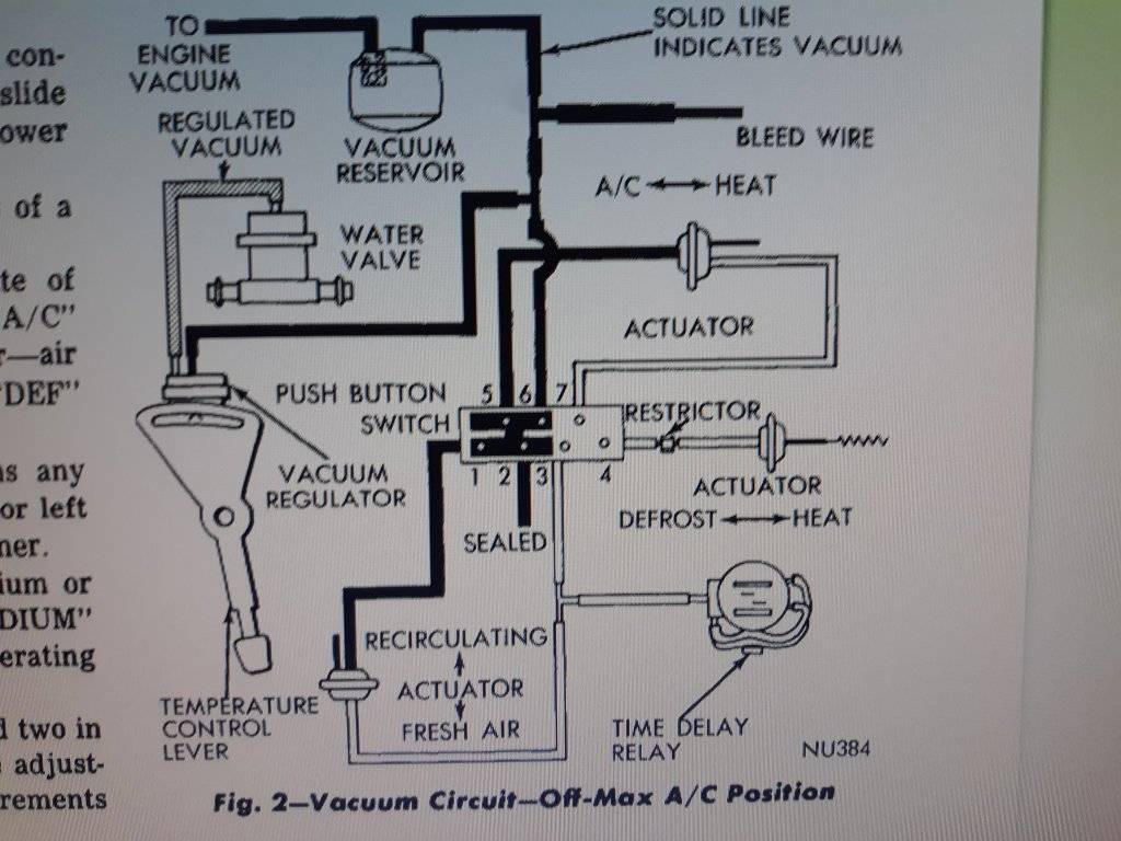

The 69-70 300 models were equipped with a time delay switch (as @Big John suggested) located behind the glove box next to the fresh air recirculating door actuator. If found unplugged or vac line(s) missing can cause no A/C actuator operation. Also degraded foam seals in the heater box will cause improper air flow as you stated. In the case of no heater temp blend Check for kinked or broken vac line(s) in either the supply vac hose to the vac controls as seem in the diagram below. Removing your radio will greatly aid in the ease of repair and diagnoses DO NOT attempt to rebuild the vac control switch, there are too many out there in NOS condition and will give you fool proof service for many years. Any Questions PM me.
