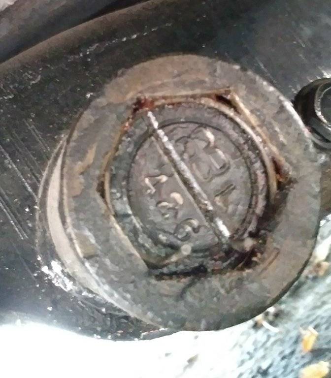

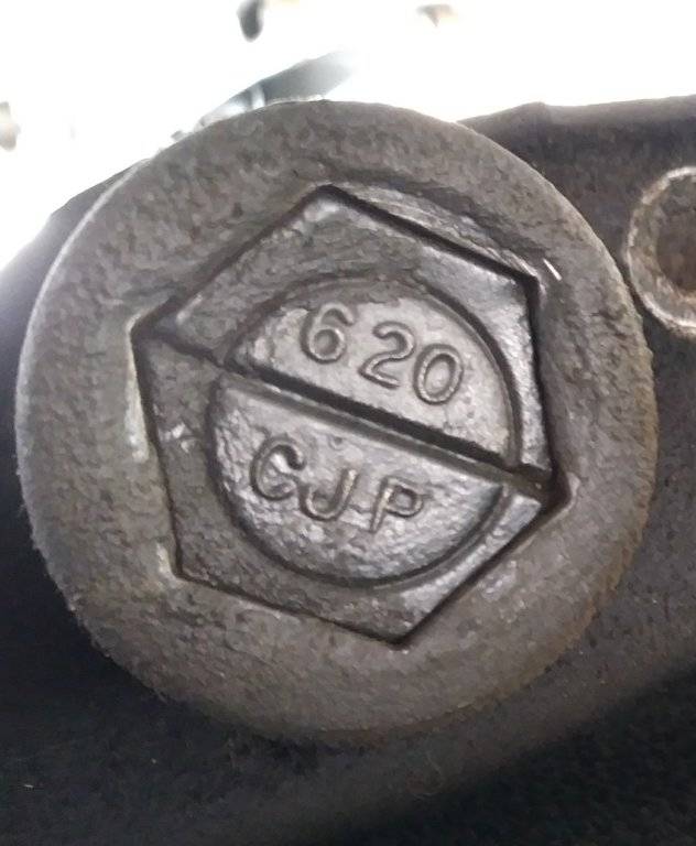

    Can anyone tell me about the difference between these two torsion bars?

    One is currently in my newport...the other is in another frame.

    One end has date, other end has last 3 of part number, which is on the broadcast sheet. Bars can go in either direction, front and rear doesn’t matter. The L or R side does matter.
    426 is 42nd week of 1966.
    620 is 65-69 C body 383/440 and 70 383 in gg book

    Ah...ok...that explains why I couldn't reference the 426 number. Mine must be in backwards showing the date instead of part number. I found info about the various bars and it seems one set is clocked at 40deg and that other at 44deg. What significance does that have assuming both are the same diameter.
