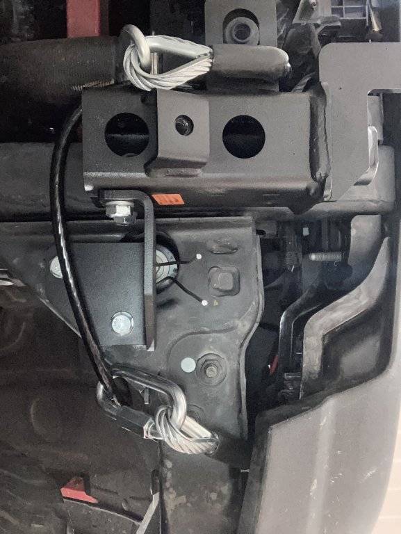

I am installing a tow kit in Lucy, my fiancé’s 2021 Bronco 4WD 4 door.
It’s a Blue Ox set.
Got one side done.
Electrical will be done once the mechanical mounting is done.
Driver’s side, fwd is to the left:
View from underneath, fwd is to the left.
I’ll cut the rods hanging down after I finish up the safety cable that’s looped around the front crossbeam.
This all gets covered up with a plastic cover. Also, a no scar mod (to the vehicle, hands not included).

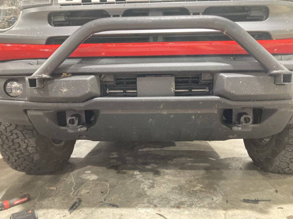

Well, I installed the wiring kit that I ordered from Unleashed Tuning, specifically made for the Bronco.
The kit installed fairly easily.
