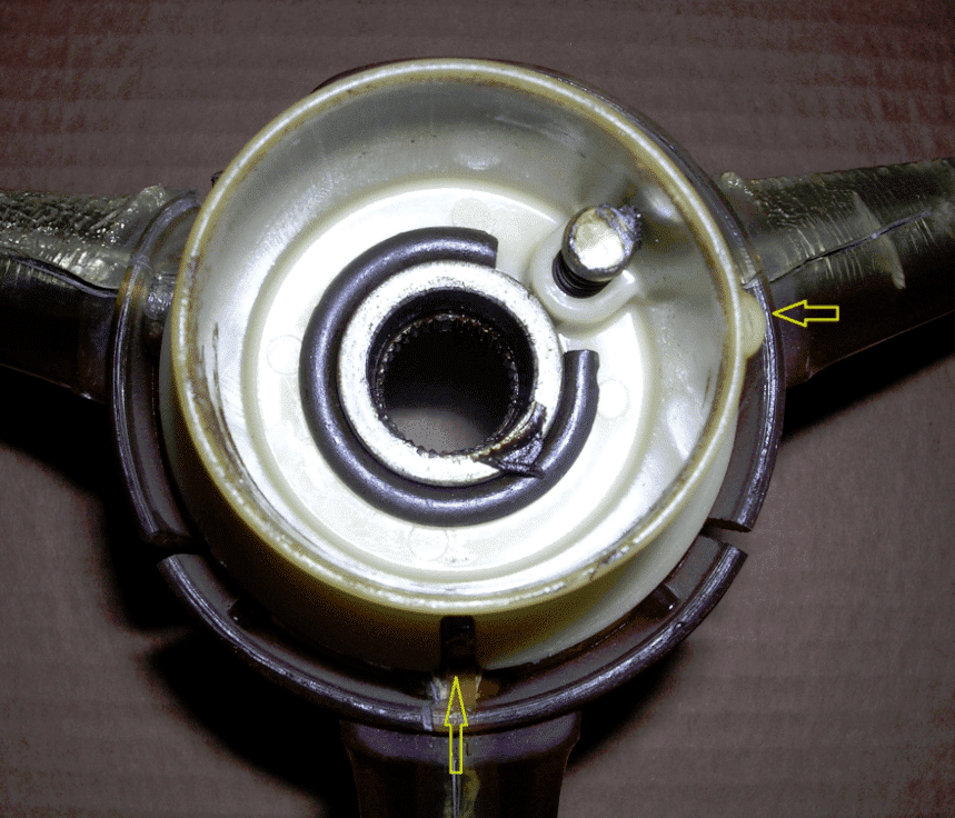

Okay, so this is the 'plunger' or cancelling cam.
The yellow arrow is the cancelling cam and the green one is a locating guide.

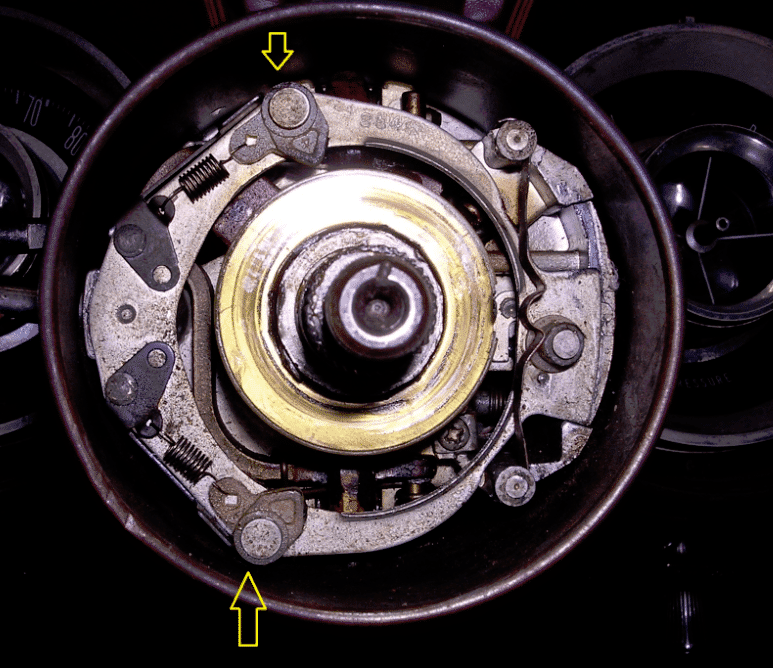

This is the view inside the upper column, the arrows show the cancelling tabs. Also shown in the right turn position.

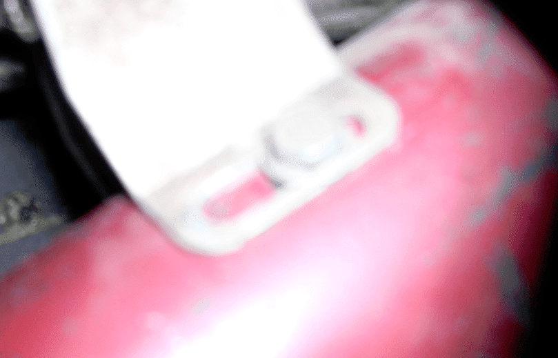

This is a bad image (shooting blind), but you can see the adjustment on the switch bracket, left side shown but one screw on each side of column.
Signalling for a left turn moves the cable out toward the driver sliding the switch aft, while a right turn is opposite (duh!), so if it's a switch adjustment that may help with which way to go. Happy hunting.
As an aside, I need to move the plunger to the new wheel first and I'm having one devil of a time figuring out how to remove the retaining ring shown at the bottom of the plunger. The fun just never stops.

Thanks! This helps a lot. I'll probably dig into this over the weekend.

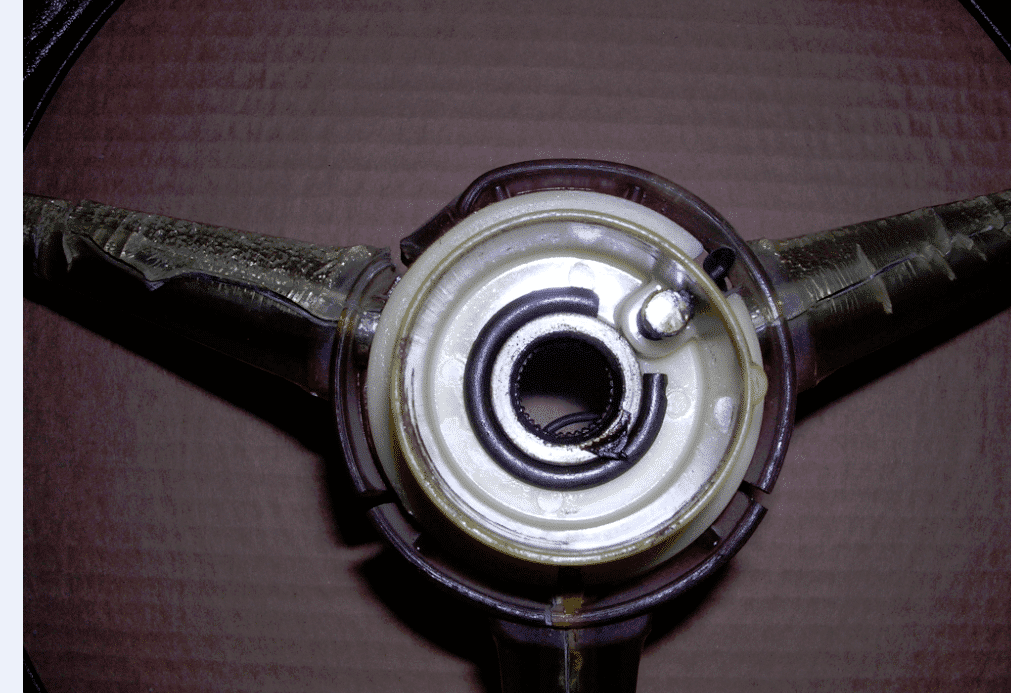

So when looking at the wheel upside down, the cancel "bump" should be at about 2:30?
No, that pic was at a bit of an angle, more like 3:00. Here's another pic from a little different angle and farther back, pretty much a straight on view.
