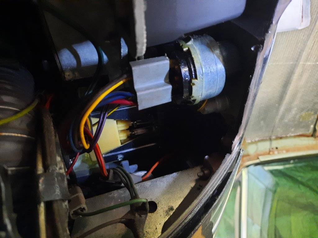

I am installing leds on my NYer. I have to change my flasher from the mechanical to and electronic one. I have pulled the panel under the steering column, checked under the ash tray, checked the ledge below the dash and I cannot find the damn thing. I have to wonder if it is under the air conditioner. Anyway, it is not on the fire wall. I have changed them before so I know what they look like. When I turn signal on, there is not sound. I have been looking for days.
You know I converted to disk brakes, made the power windows work and many other jobs but this is stumping me. Any ideas? Am i looking at it?
It took me a while to find it on mine.
It is next to the ashtray, just between the lower dash panel opening and the ashtray and its clipped to the dash.
