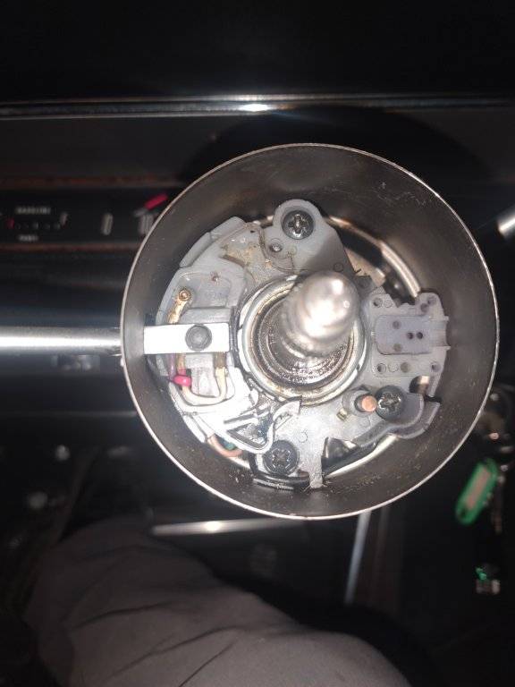

Trying to replace the turn signal switch in my 68 New Yorker, but when I bought one it will not fit. I was researching the switch/column when I found this website. I am hoping the knowledge of the group will be able to help me. I have found switches on Ebay and other sites, but they are either blue or red. As I understand it, the red was for a Saginaw column, a blue one is for the Chrys column, but I have a white unit. I do not have tilt or telescopic, but it does have cornering lights. Mine the little clip that hold the switch in the on position is broken. Tried to super glue it, without any success-broke back off when testing it. Or is mine just a aftermarket switch??? It looks very much like the red one for Saginaw columns. Thanks in advance for any help.
Head over to www.mymopar.com and (free) download a Chrysler Corp Factory Service Manual. There should be some illustrations in there on how to change the switches and could well define which one you need (by looking and comparing the FSM images to what you have).
I believe that "Saginaw" = Tilt/Telescope steering column?
RockAuto has images of most of the parts they sell in their catalog section, fwiw.

Try this link instead…..but I have yet to find a digital copy of the 1968 manuals or Parts Books on mymopar.
Service Manuals – MyMopar
I got a switch from shee-mar for my ‘68, but it is a tilt/tele column. Looks like all the shee mar products can be found on rock auto

On items which ALL C-bodies might share in a particular model year, as the steering columns were in '68, the 1968 Plymouth FSM covers the Tilt-A-Scope column, ATC system, and other things of that nature. Sometimes I forget that the listings might not be all inclusive, but with a little bit of knowing what fit what in what model years, alternatives can usually be found, from my experiences.

I also had problems getting to the correct website, but found by manually typing in the URL, it went to the desired one. The parts drawings make me think my switch was replaced at some point years ago with an aftermarket one. I have tried some of the cancel repair kits and they would get the turn signals to work, but I lost my brake lights, or they flat out didn't fit. I think I will try the one from rock auto as it shows the purple wire for my corning lights. If it is wrong, I can always send it back. Thanks for the suggestions.

Rock has them at 105 for standard columns and $322 for tilt/ tele columns
