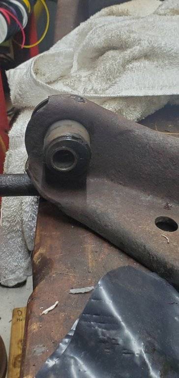

UCA Offset Bushing Install

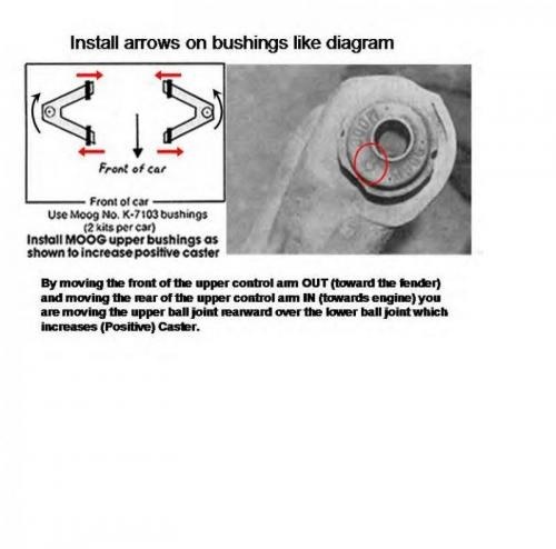

I have used the offsets on A,B,E bodies, I have not installed the offsets on a C-body yet, I have only had the privilege to work on C-bodies and Imperials that have already been replaced or not needed. Saying that, when it comes time to do my bushings I will use the offsets. Mostly out of habit and that Chryslers cars have very little caster originally

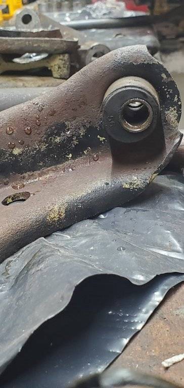

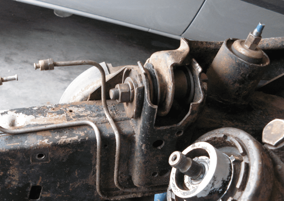

Small victory, I have the front suspension rebuilt and everything reassembled except for the steering linkage sitting on the bench ready to reinstall. I did find a bent strut rod and tie rod sleeve on the passenger side so it may be the car was in an accident at some point. Luckily everything came apart and went together easily, likely due to the engine oil covering everything. Sad how engine oil destroys rubber but keeps the metal bits in tip top shape!
I won't know for some time how much of a difference it makes since the car isn't operational at the moment. But I am excited this job is done and can't wait to get her back on the road. Hopefully before 2026!

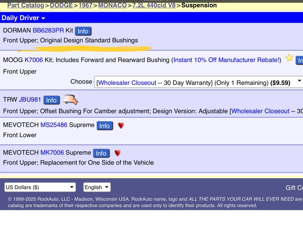

I ordered Mevotech from RockAuto for everything except the lower control arm pin bushings, those came from Kanter. And the UCA bushings were Moog, shipped in a Mevotech box. Time will tell how well things hold up.
Oh, and the Lower Ball Joints were old stock Moog ordered on E-Bay. Not cheap but they seem to be of great quality.
