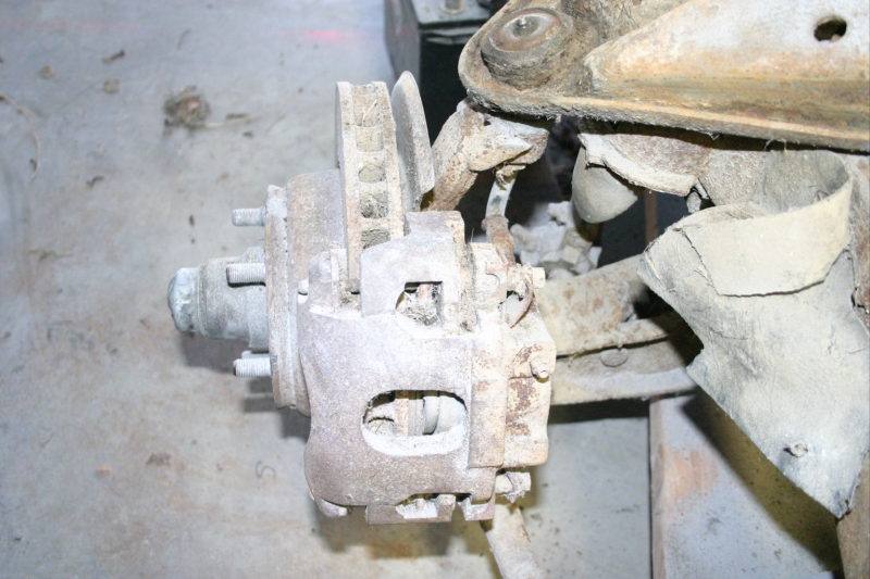

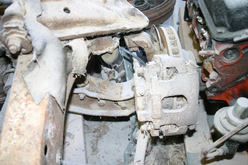

Yes, Greg, the two in your pics look different, but if they fit and work, I wouldn't worry about those cosmetic differences.
What you have basically are the same caliper of different design.
When the Kelsey Hayes, single piston caliper, on the "C" body cars came into existance, the caliper was cast as whats known as the "wide mouth" design in 1969 and 1970.
In 1971 the casting was changed over to the conventional design with the smaller "openings" that everyone is pretty much familiar with.
