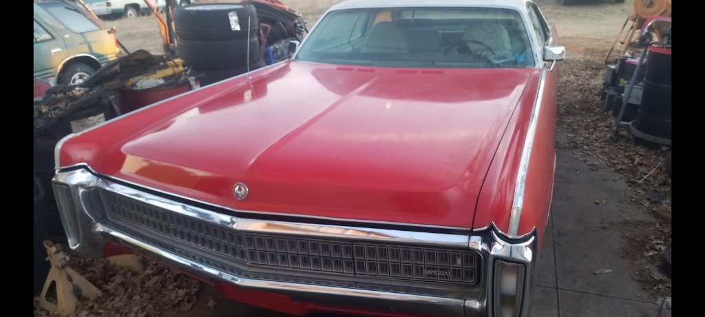

its a 4 door - I am talking about a two door (I could use the IMPERIAL nameplate off of the rear truck lid)

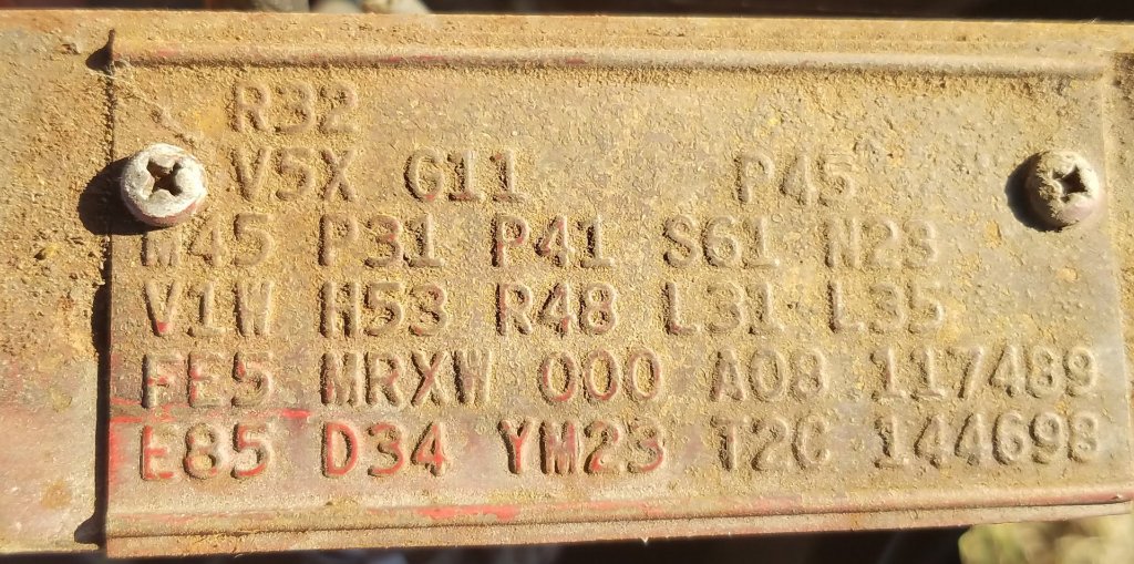

Yup, Red with white vinyl top is correct. I don't know what A08 is that year (a package of some sort), but.....H53 is auto temp A/C, R48 is power antenna, L31 is fender mounted turn signal indicators, L35 is cornering lamps, M45 is fender skirts, P31 is power windows, P41 is power door locks, S61 is tilt/telescope column, N23 is electronic ignition, V5X is black side mouldings, G11 is tinted glass, P45 is power trunk release, and R32 is dual rear speakers.I'm in the process of restoring my 1972 imperial Le Baron, looking into replacing the oil white vinyl top. Can one of the "seasoned" Chrysler members decipher my data plate. Wondering if the white top and red paint are original. I looked on-line without any luck. Anyone know how to speak c body braille ? I thank y'all for any help.
A is October and 08 is the eighth day of October.I don't know what A08 is that year (a package of some sort),
October 8th 1971? That explains the AVS carburetor instead of a Holley.A is October and 08 is the eighth day of October.
A08 is the SPD or Scheduled Production Date
