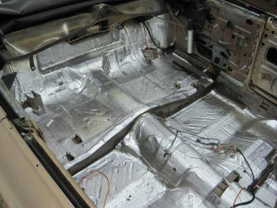

I bought a cheaper alternative than the hushmat. It is a great product and easy to use. This is the second car I have used it on. If you are going to change the carpet, laying down the hushmat on the whole floor, every carpet I looked at, came with the fiber insulation too. So I have both. Here is the product I used http://www.b-quiet.com/ultimate.html What ever product you use, buy 50 square feet, that is about perfect to do the whole floor.
